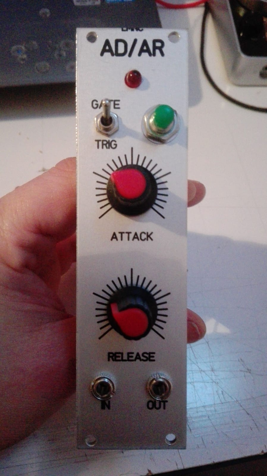

Good morning from Germany! Unfortunately yesterday it was too late to post any progress. But yesterday I got 4 panels ready and @EddyBergman 's Noise Module completely finished except for the potentiometer caps. Everything in Eurorack size.
Excellent work! Looks very professional.

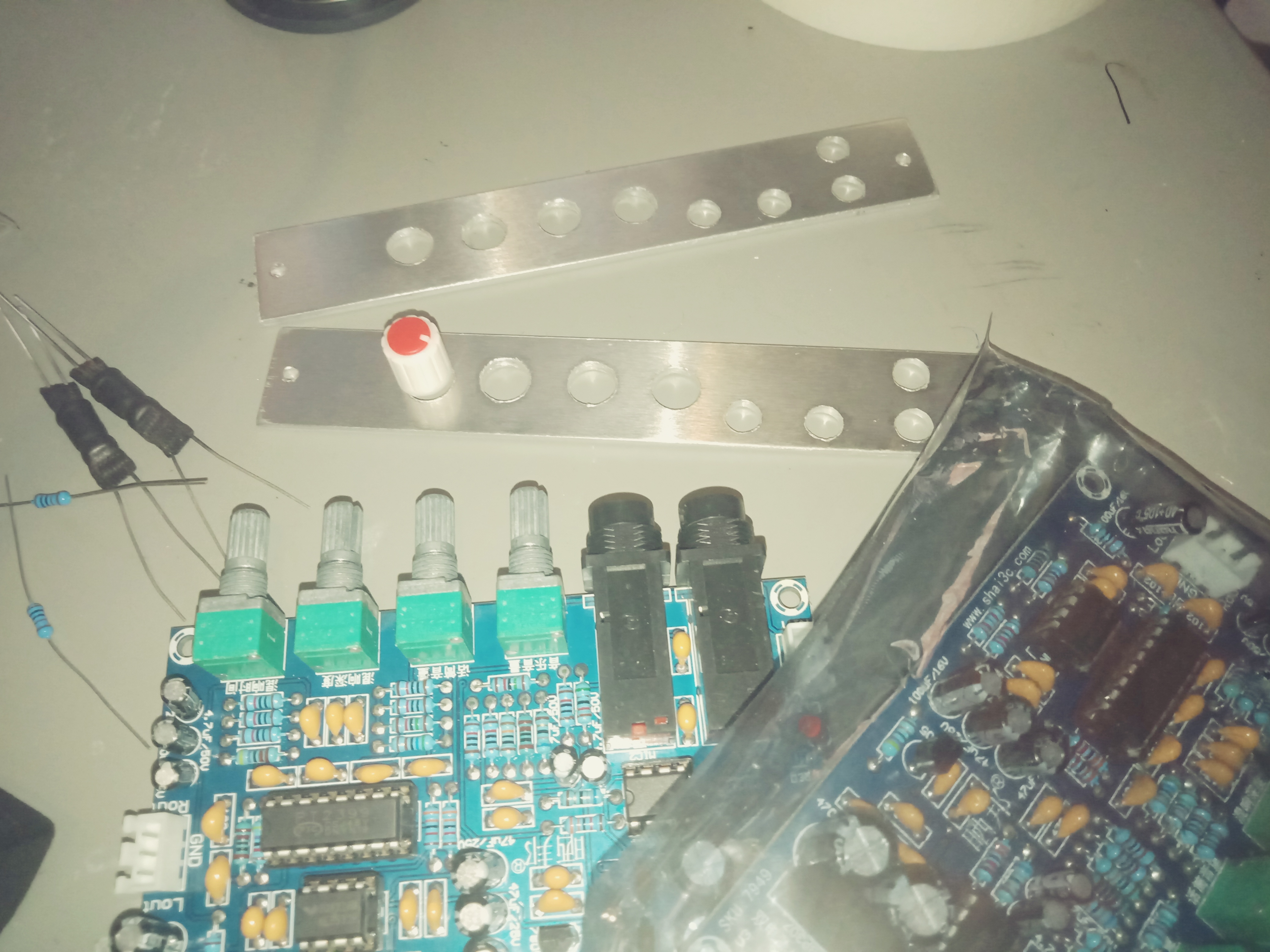

I might just have to spray paint these panels (my best attempt yet I reckon) - 2 matching karaoke delays
Horrible knobs though
I think knobs are extremely important !! I’ve started with these blue or red and black, hold the cheapest. They always look like you’re in an electrical laboratory. Which is also cool sometimes. But let’s not kid ourselves, the Davies 1900 clones or MPX style buttons just look nicer! And give the module IMMEDIATELY a different charisma.
