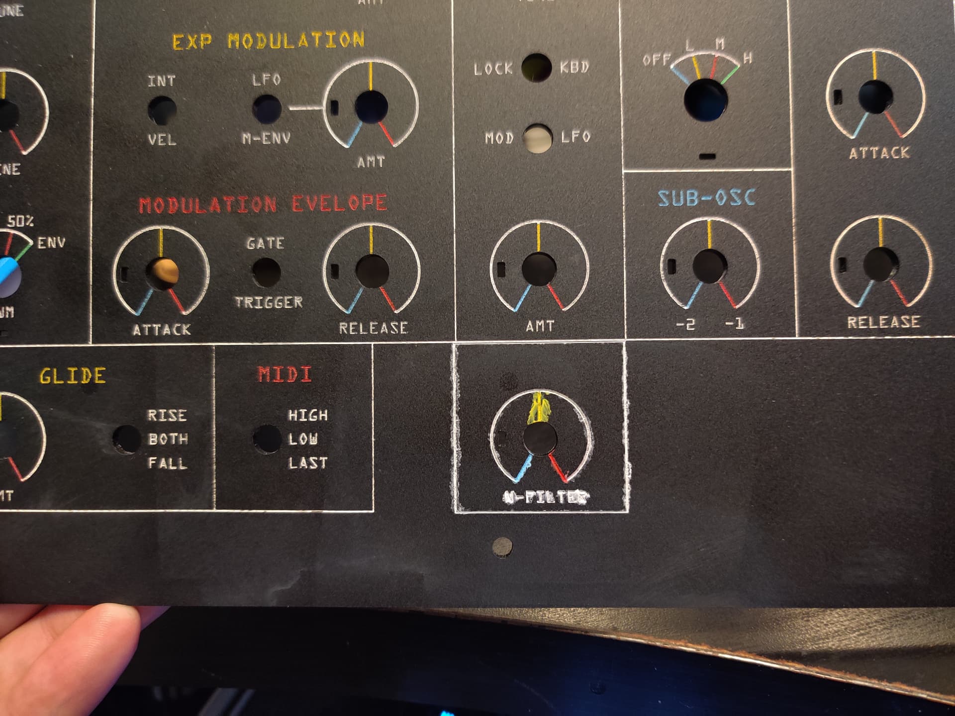

POSCA markers are worth their high price if you have a good use for them. They dispense acrylic paint, not ink, making them suitable for many uses where ink won’t stick. I like to use them on 3D prints. One example:
(not exactly my cleanest painted 3D model, as the features are very small, but I wanted to post something synth-related)
Poscas are great! I use them to fill in the etched features in my laser etched face plates. They are very opaque and easy to clean off which alcohol if you make a mistake.

What material are these face plates made of?
The control panel is matte black acrylic and the back panel with just the text and ports is smoke/grey mirror acrylic.

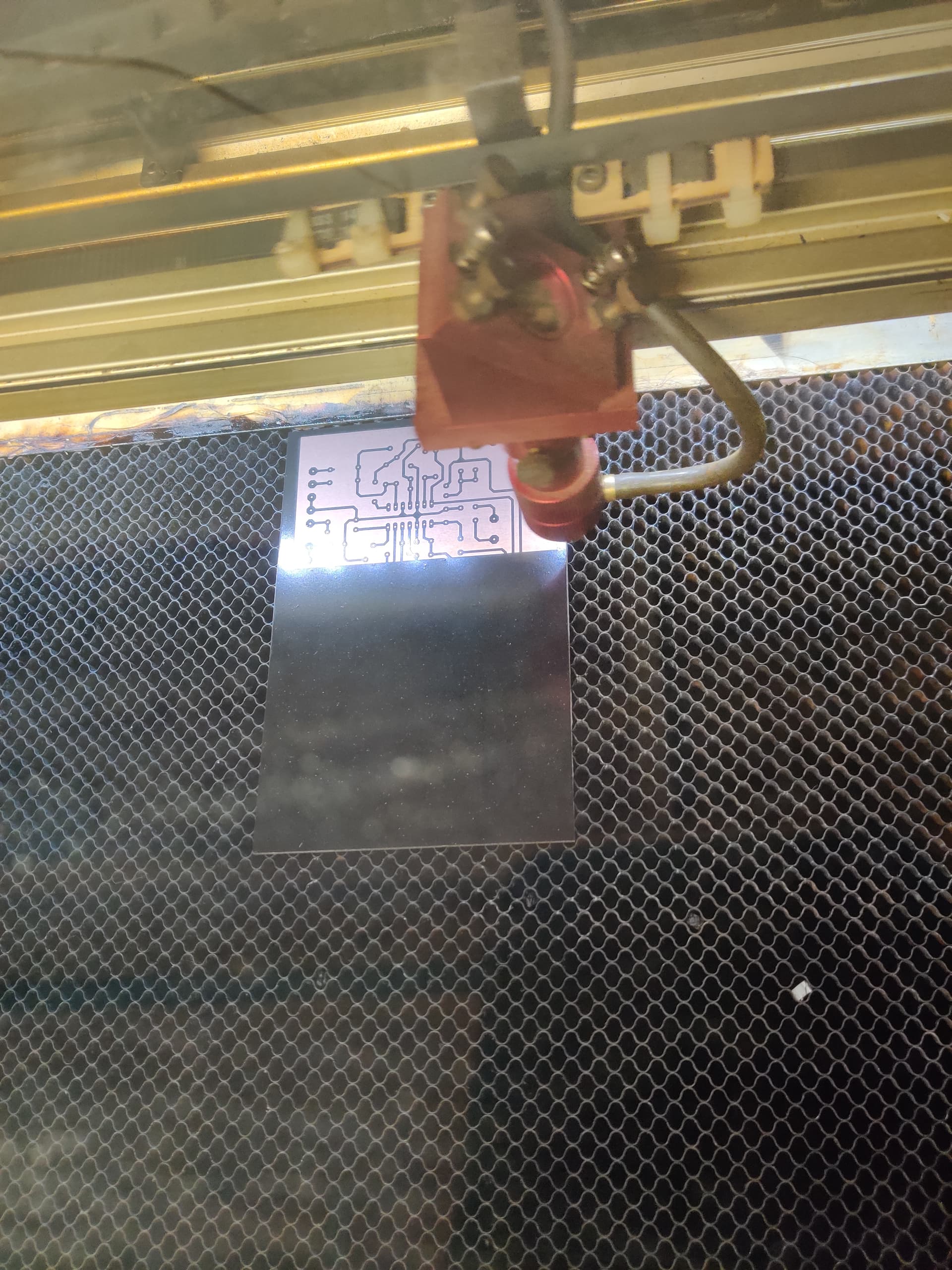

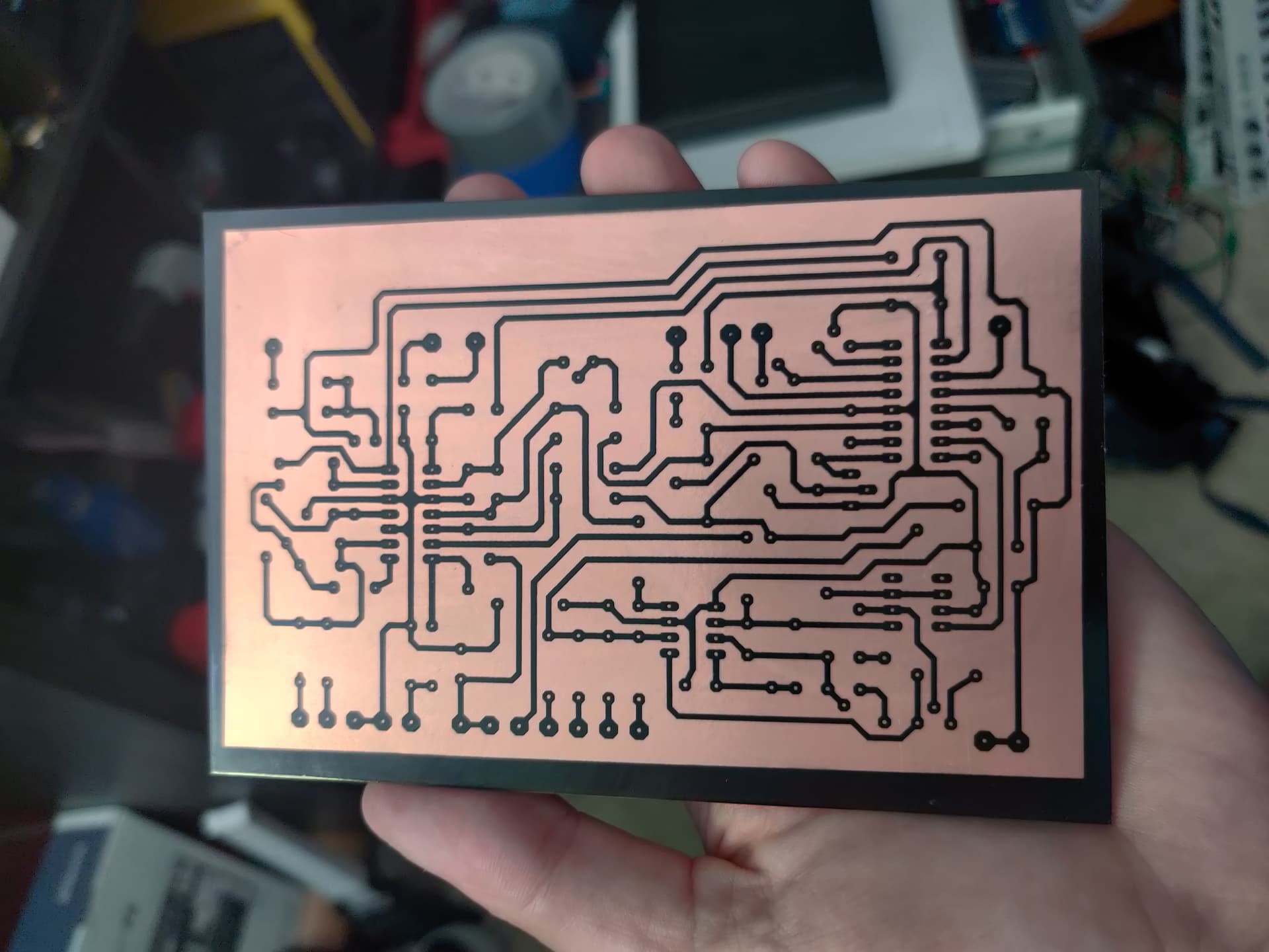

So I remembered using a laser to create the resist layer for PCB etching was a thing and that I have a laser. So I am giving this a try for the XR-VCO. Should have my ferric chloride tomorrow. I am pretty optimistic this will work really well. Too bad Thomas Henry’s PCB layout is kind of ridiculously big and won’t fit properly in Eurorack. Maybe it’s time for a Kosmo case…
Light alcohol cleaning seems necessary.
I wonder whether a shiny surface could damage the laser head in some way because I noticed when trying to cut some thin aluminum foil (which did not work) that the air assist nozel got really hot, which normally does not happen. I gather this was caused by excessive reflections. Any opinions?
CO2 lasers can’t cut metals, only organic materials. For that you need a fiber laser. For this I am just etching away a layer of paint, so I am not worried about reflections. You can etch anodized aluminum, but all that’s doing is breaking down the anodization.
