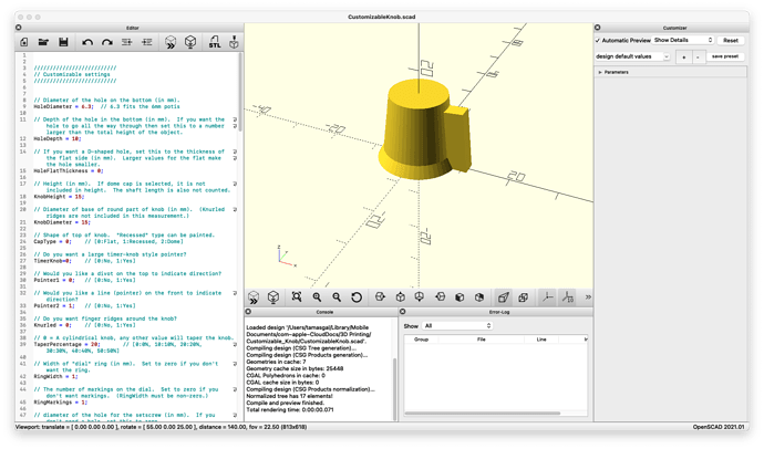

This is what I am using:
The file can be opened with OpenSCAD and then you can tune all kinds of parameters and generate the STL file for slicing:

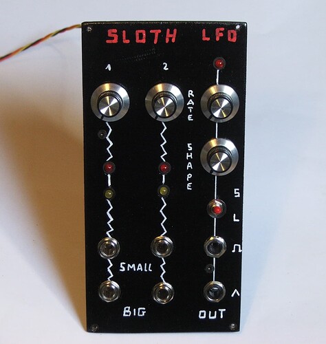

Dual Sloth Choas + simple LFO in the case :slight_smile:
schematic from Non Linear Circuits
I used it in PWM and in several filters in this short demo

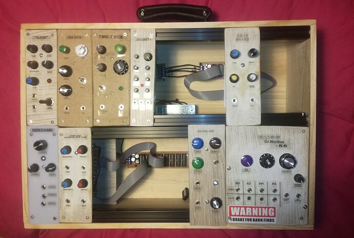

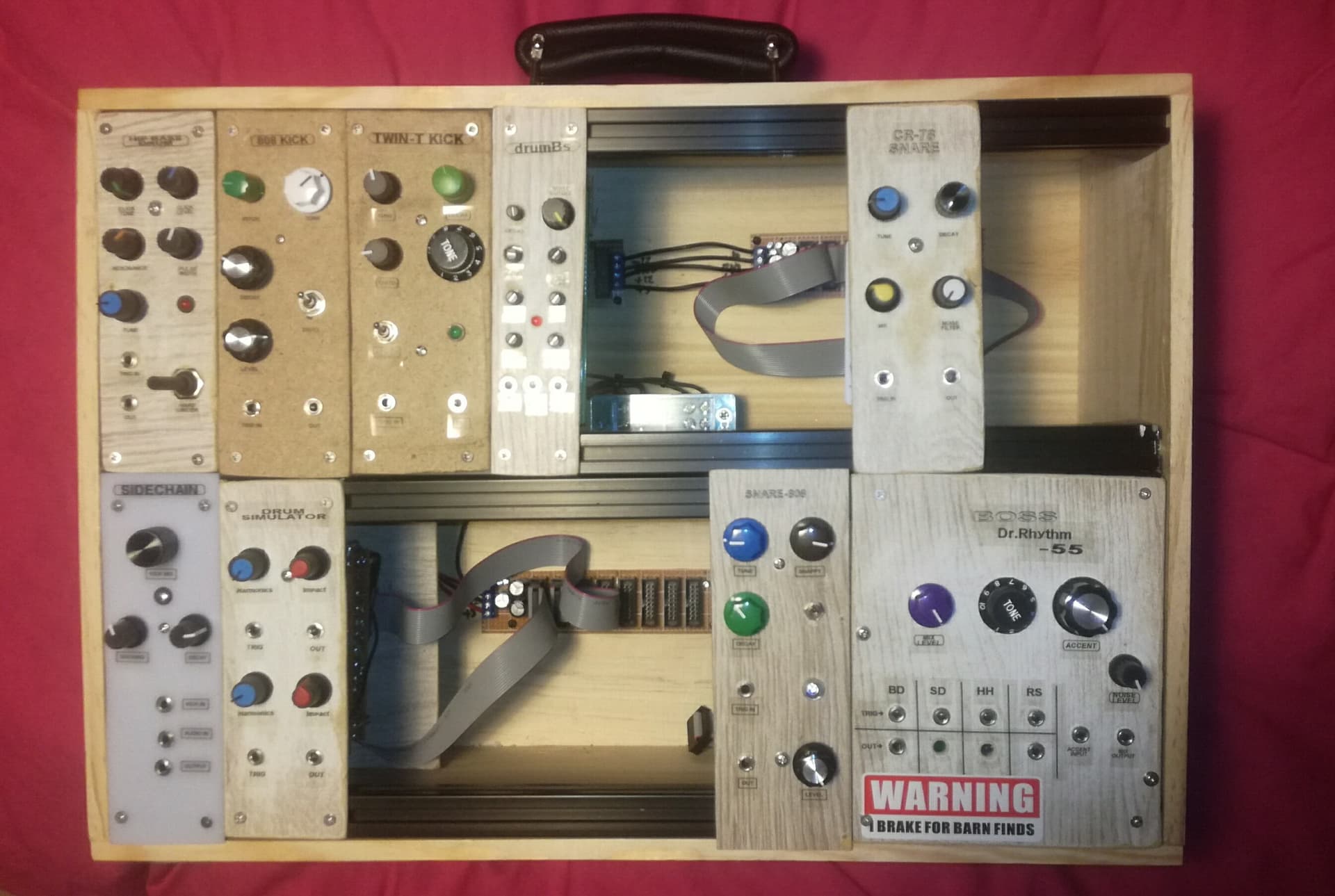

a snare drum module inspired by the beautiful CR-78 vintage drum’s machine:
schematic available here: CR-78 Snare module - MOD WIGGLER
My drum’s dedicated case grow up !

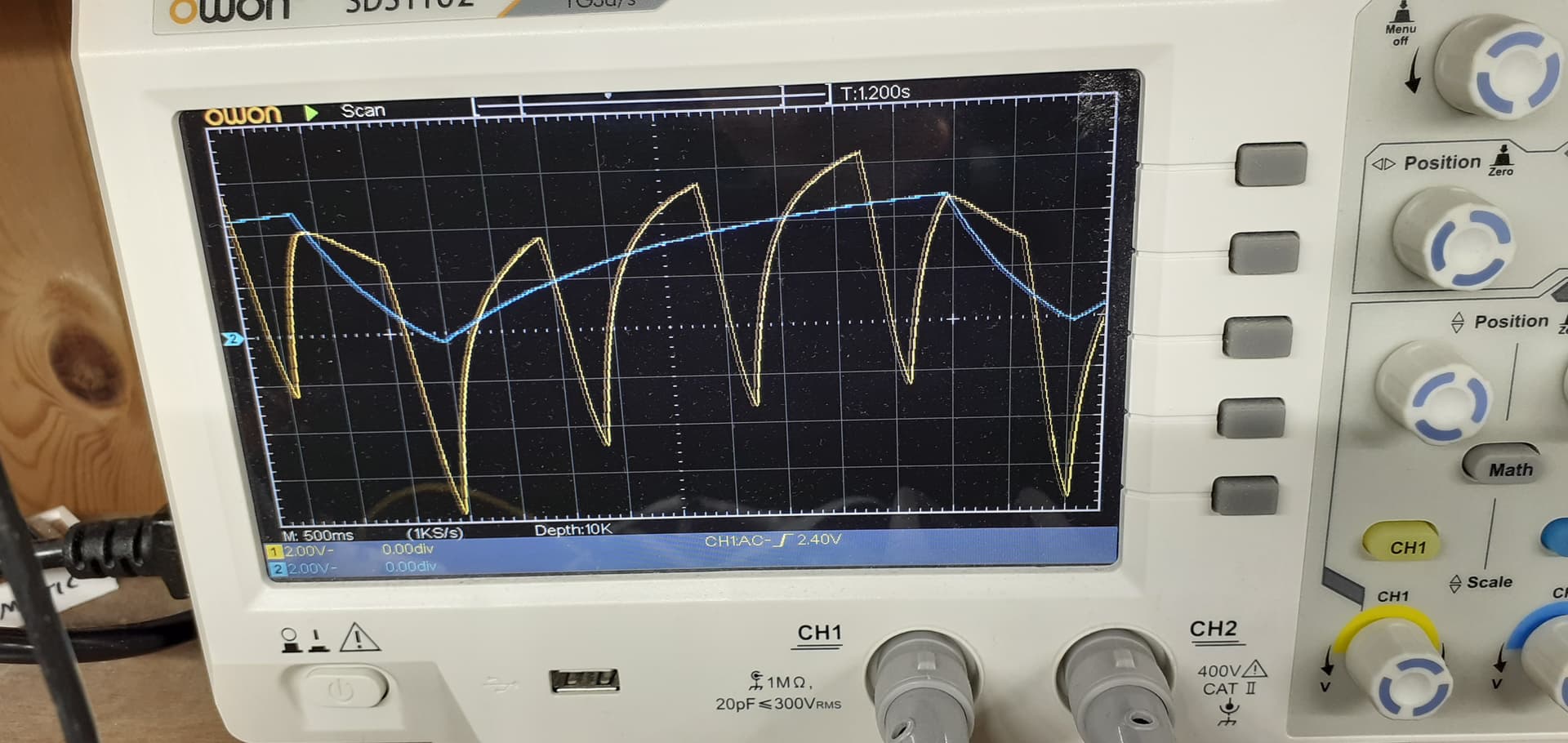

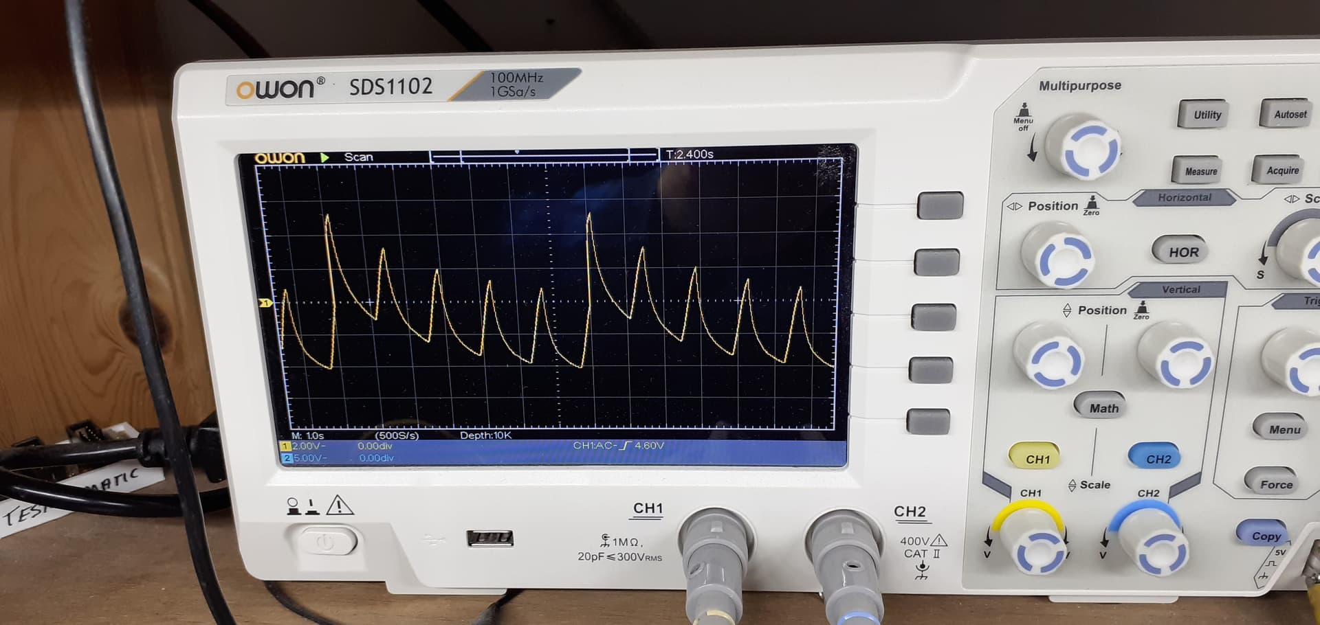

I’ve been testing my quad envelope generator. Here are some pics.
2 of the 4 PCBs under test. They are connected via a bus. Here the 1st gets a clock signal and starts an envelope and triggers the second generator (a bit later) as well.
One slow looped envelope in blue and a summation of this with a faster looped envelope in yellow.
And other slopes are possible as well. It all depends on the time constants, envelope amplitudes and the polarity of the individual envelopes.
The envelopes can also be used stand alone.
