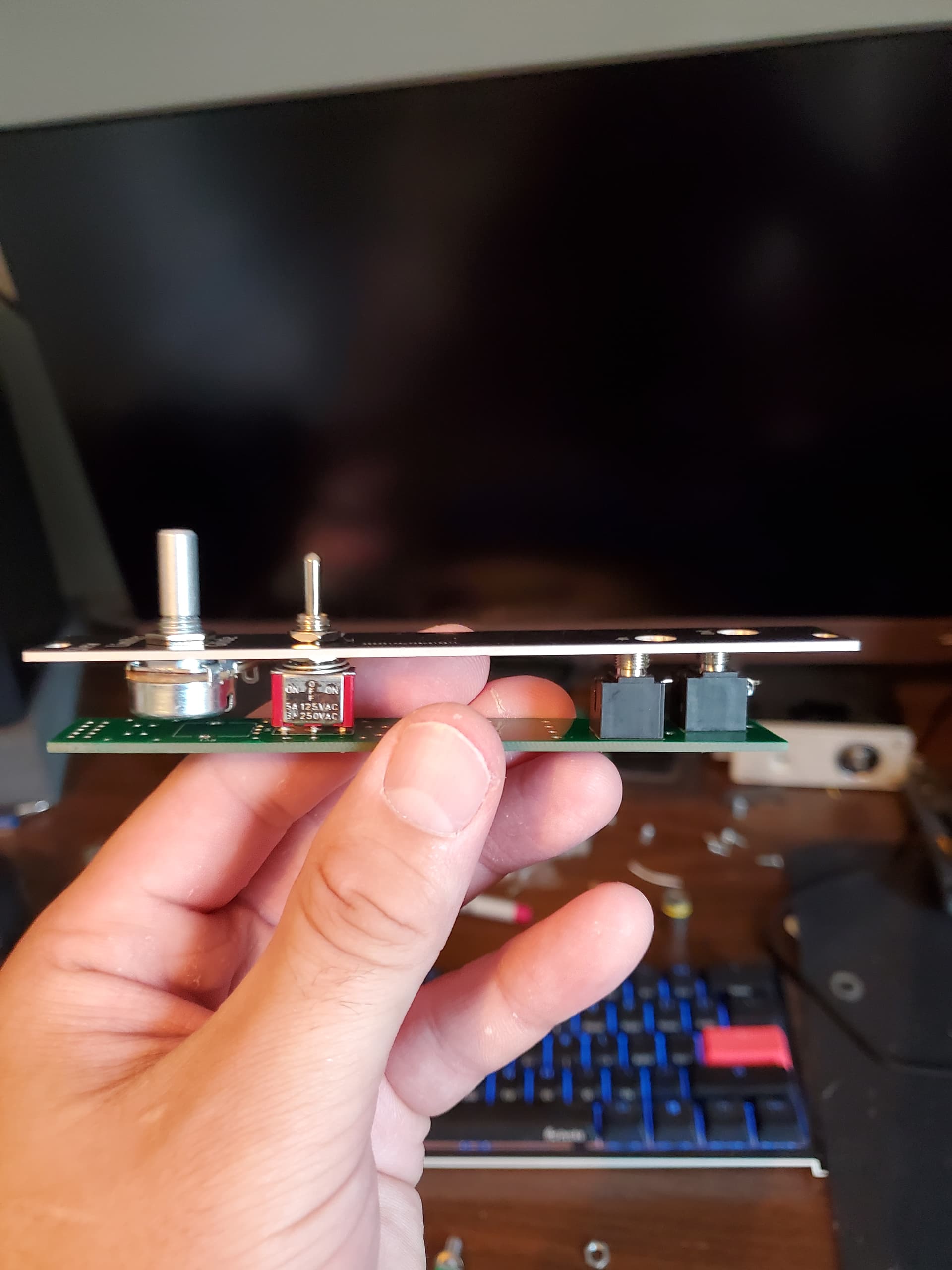

I haven’t built anything new yet, but I did get my first my-designed PCB and panel back from JLC which was very exciting. Except that I messed up the alignment on my panel. Dammit! I think it will be salvageable at least though. I popped in a switch and the jacks without soldering them - the hole for the switch is only slightly off, so I think I can force it into place, then I have room to pop in a non-pcb mount small pot and wire it to the board. So game plan is to build it, drop in (don’t solder) a PCB mount pot, measure the distances between everything so that I can fix the panel, then wire up a different pot and hopefully squeeze it into the panel so I can use it for now. It’ll be a bit before I order new panels - no sense ordering and shipping one off panels, I’ll wait until I have some other stuff to order as well.
Also need to spend a bit of time looking at the project and seeing where I went wrong so that I don’t make the same mistakes next time. Also need to remember to get JLC to put the batch number on the back side of the panel next time round. The pot is so far off I feel like it wasn’t a mistake lining things up so much as a slip of the finger and not double checking or something like that…or making a revision on the board and not updating the panel or something. Theres no way I can see that I would have put the hole there thinking its where it should go… but I dont know.
Hoping that Sunday I’ll have time to build it and see if it works. Such a low part count build, I should be able to bang it out very quickly, but I picked up a last minute sub in gig for Saturday, so my free time this week is going to be learning new songs.
Nice work getting your first pcb’s fabricated, it can be a daunting process but it does get easier. I think most people here have redone pcb’s, I have made similar mishaps and much worse.
Nice work — yeah, even if you write yourself a checklist, there’s a lot that can get missed easily.
Over here there’s mention of how I handle making panels and PCBs consistent — layout in Inkscape, hole positions exported as PNG and imported to KiCad as a footprint, and then line things up with that. (And I try to keep everything on a grid.)

This is smart, I ended up using the KiCad caliper tool and just measuring everything down to the sub-millimeter. Using a footprint as a template makes a lot of sense.
I’ll give that a read after work today and I might message you if I need a hand, if that’s cool. My workflow was similar - I think my problem came from not knowing exactly where to put the cutout holes in relation to the component footprint.
Away from my computer but I think I lined up the cutouts to be over top of the “do not fill” circles for the Thonkiconns, then dead centre for the switch, but I think maybe they should have been centre of the Thonkiconns too and that’s where that problem came from? Need to double check that later
Again, I think the pot was just a weird brainfart unrelated to to the above confusion
Among my custom footprints are pots that are the same as the standard ones but centered on the shaft instead of the first pad. Because the standard ones are a pain to line up.
