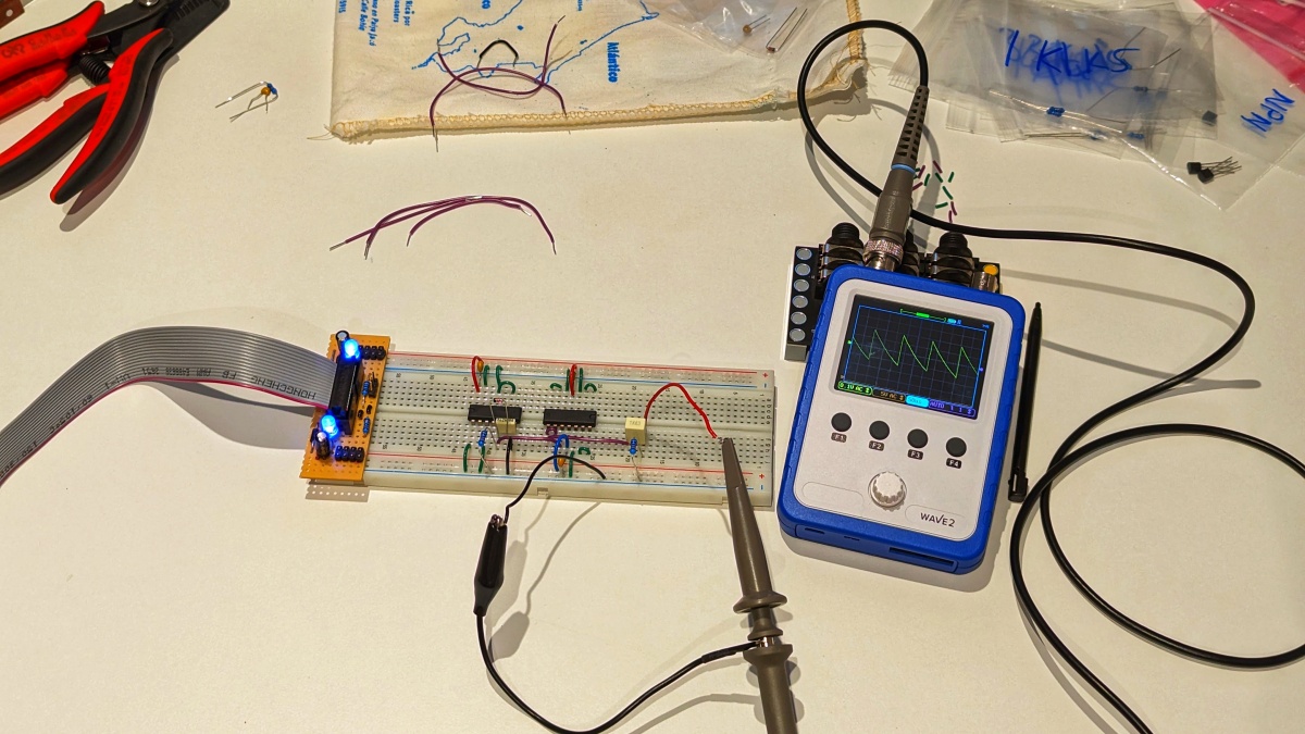

New breadboard, new oscilloscope. Nearly back to where we were a few weeks ago with the @moritzklein x es.EDU VCOā¦

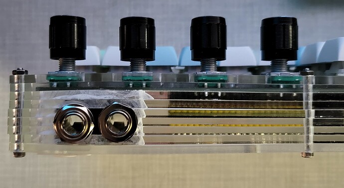

I added some modifications to my latest project:
- a way to reach the sd-card without dismantleing the whole thing
- pre connected big jacks to bring it up to kosmo spec and protect the mini jack on the rpi

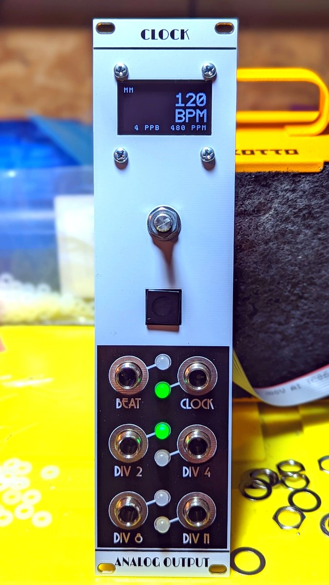

Here I am trying to design my own clock module, and it appears you have beat me to it.

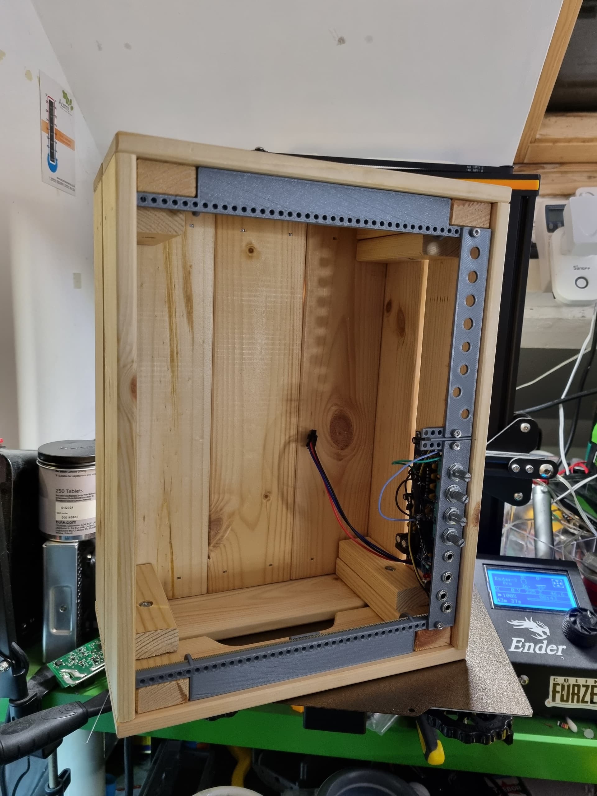

Hey gang.
My old cobbled-together case was rubbish, so Iāve started cobbling together a new one. Two rows of 40HP Eurorack is in progress. (Actually 41HP, because I havenāt really got much of a clue what Iām doing. I wish Iād gone for 40 properly so that there could be a comfortable margin at the ends.
The box is an IKEA crate. I love them for projects, and I had the usual bit of IKEA serendipity when I discovered that there was just over 257mm between the corner supports if I cut one half of them back a bit. 257mm = 2*128.5 = two rows of Eurorack modules. Nice! (Iām resisting saying 3U/6U because Iām a pedant and, having read the Doepfer specs repeatedly to get the sizes right, I know itās a bit hand-wavyā¦)
Rails are 3D printed, 4mm deep 2.85mm holes mean M3*6 screws will cut their own thread. Iām working on the central one at the moment, as is probably obvious! I designed the rails to go around a 6mm threaded steel rod for strength (selected because Iāve got 8 metres of them on hand) which Iāve cut slightly long so that it can get pushed into the soft wood case to help brace it. The top and bottom rails are then screwed into the top and bottom pieces of wood as well.
The central one is going to be in several parts to aid with the printing - the alternative was to have masses of support - and I think the rod will be slightly longer again, with holes drilled in the case for it to go into and printed endcaps to cover.
Although Eurorack sized, Iām using my own power connection standard because I donāt actually have any āproperā gear that demands the 10-pin connector.
Anyway, there you go ![]()
Following up from yesterday, I now have a 3D printed/wooden/threaded steel rod Eurorack case. Last thing to make is a lip to go across the middle, and glue it in.
Mixer and two (unlabelled) PT2399 reverb modules mounted temporarily, I havenāt made any other Eurorack-sized panels yet. Power etc will get sorted out first, though.

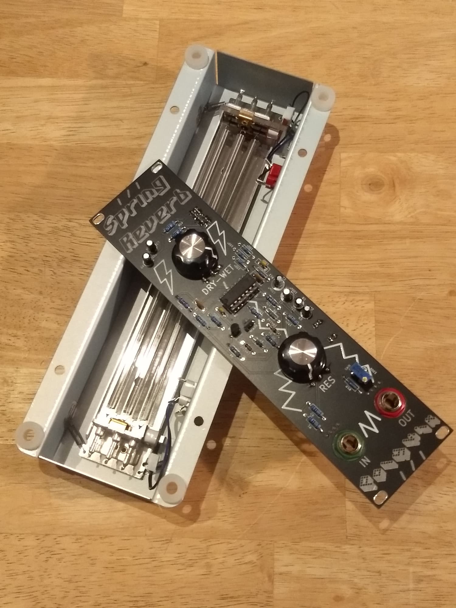

Finished a Polykit Spring Reverb to drive an Accutronics 8BB2C1B
Another one in the making to drive a 9BB2C1B (42cm spring)

Did you change any values for Input Coil Impedance?

I used the recommended values for 150ohm input impedenance.

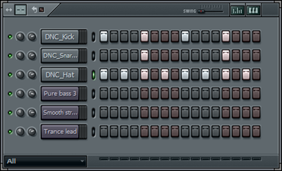

Itās basically this but it outputs triggers:
You can use the encoder to fly around the grid, click to arm/disarm that step. You can feed it a clock signal to advance, or it can clock itself. Designed for triggering drums mainly.
Made with arduino nano and shift register.
Sorry, I donāt have a video for it yet! Soon.
