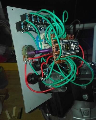

Well… No dice on being lucky and getting it right first time. Even after uploading the code to the Arduino =P
(Yes i tried testing it without the BigButton Code hosted)

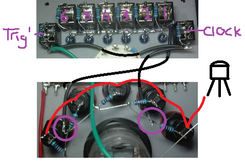

Had a look around and ive got some stuff to do. Change Big Button LED to A3 from A6 as it is in the schem, look at ground wire from the Ch’x’ Outs, check Rotary Switch Voltages…
Im putting together a list of things to trouble shoot so if there’s anything that will help… link me up schottky!
Does this grounding look ok from Ch1-6 out?
Does it matter where the Gnd is on the Mini Switches (Purple Circles)?
That green wire is a spy!.. ground wire.

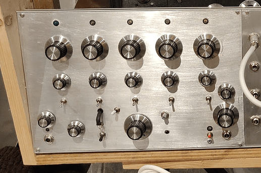

, my new dual AD/AR is operational.
as for the others that I had done I added a biggest capacitor and a switch for long or short envelope.
And also on this one I did not put the push switch for manual triggering, I realized that I did not use them on the others.

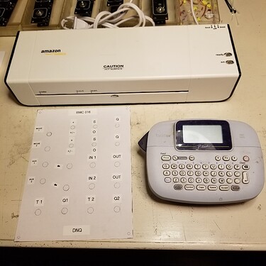

bmc # 016 dual nice quantizer . soldered up the pcb a month ago finally got around to making a face panel and wiring it up .
Very nice! May I ask what your panel making process is like?
a bit old school .
on this one I made a drill pattern [ not shown] drilled the alum. plate .
traced that [ holes ] to another sheet of paper used the label maker to mark up lettering .
scanned that , once I figured out proper scale printed to colored paper .
sealed with a plastic sheet laminator .
spray glued that to the aluminum panel .
looks a little more complicated and time consuming written out like this , but it really is pretty easy .

Heck yeahhhh, lights n flashing!
Moving A6 to, the right place seems to have done it.
Still got some bugs to squash. Ch1-6 lights up backwards from what I can see. Happy tho!
