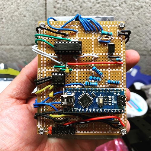

Hey, did you ever get the elkayem midi to cv working? I also built it, but on stripboard and it’s dead. I can’t figure out what I did wrong, but I followed this schematic:
I have the pcb here, but I never soldered it… I got a beatstep pro for cheap and then I heared that Sam was doing a MIDI to cv and so I lost interest… sorry
