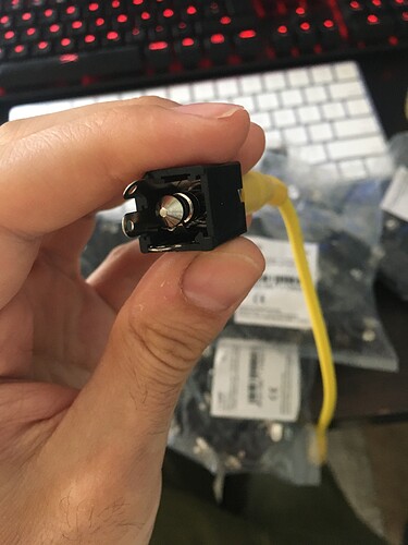

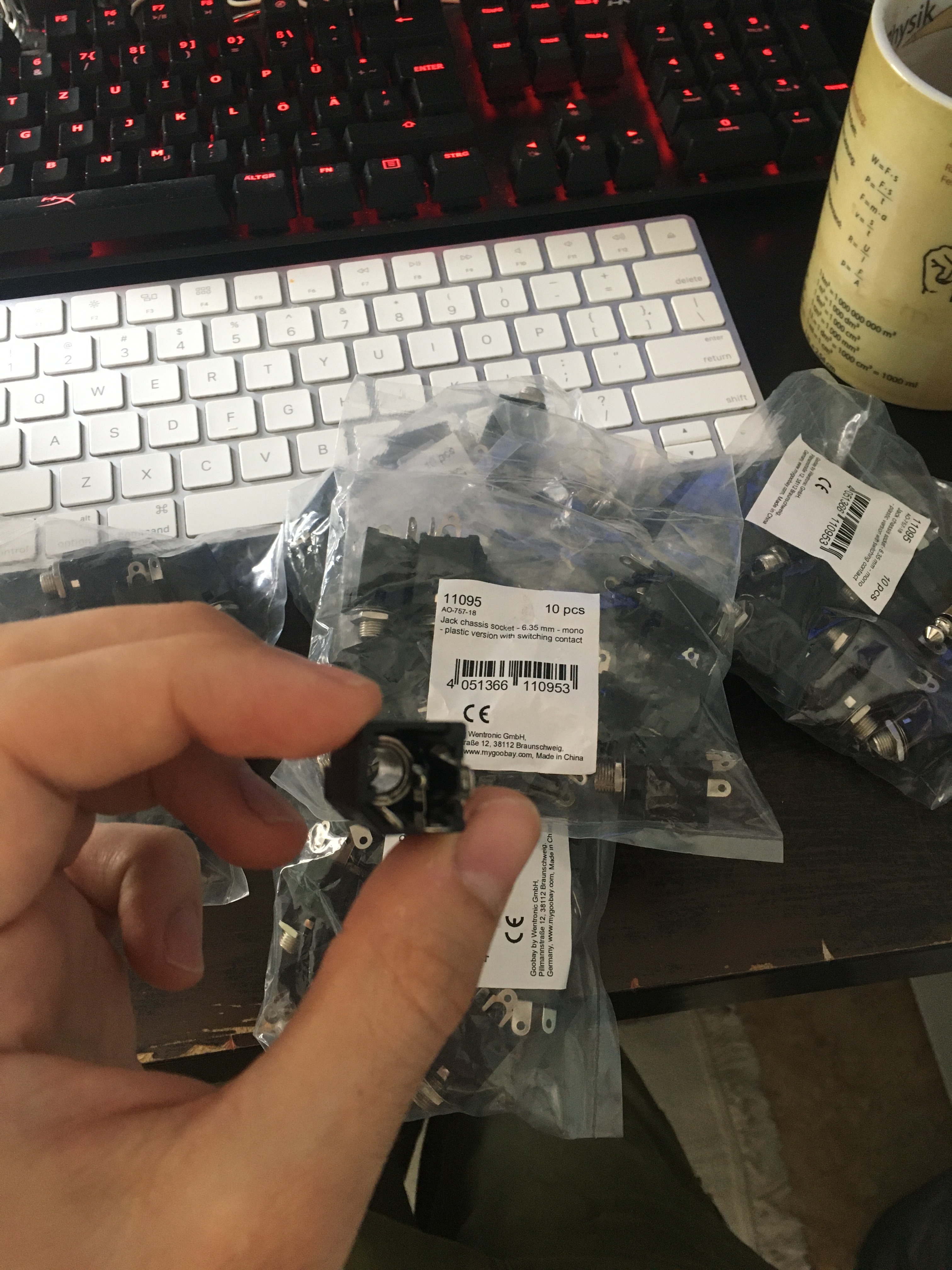

a stereo with switch, it’s like the 3rd one
But in a lot of module some mono are well.
Thanks !
But would it make a difference to use the stereo ones in all of them ?
How do i see whats to use ?
No.
All of Sam’s module’s PCBs are designed for stereo jacks.
Thanks alot !
Then ill go for them
And compare them to the Thonk ones !
Ordering from both sites will clear up the hustle.
Thonk doesn’t make it abundantly clear which PJ612A they’re selling. Stereo, but with tip normal (PJ612A-B), ring normal (PJ612A-F), neither (PJ612A-D), or both (PJ612A-A)? If the photo is accurate it’s PJ612A-A, with five terminals, and that’s what Tayda sells as well (or rather its equivalent).
Any of the above will fit the footprints, and any will work in most cases. Other than for a headphone jack on an output module the ring/ring normal terminals aren’t usually used (mono vs stereo). But the tip normal terminal is used sometimes, so you want to make sure you have at least some with that.

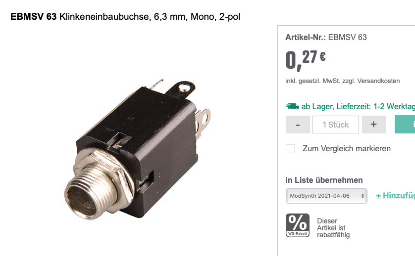

FYI you get those for 0.27 EUR from reichelt.de
https://www.reichelt.de/klinkeneinbaubuchse-6-3-mm-mono-2-pol-ebmsv-63-p36198.htmlWell thats very interesting xD !
I literally ordered from Thonk a few minutes ago.
Have you tried them ?
Are you sure they fit onto the pcb ?
The contacts look really big or am i mistaking ?
Ah sorry I misunderstood, these are not meant to be soldered on the PCB.
Yeah i talked about tht components for the Kosmo Modules.
Or are we double mistaking each other xD ?
I thought it’s about the “switching” property (and price tag), never mind

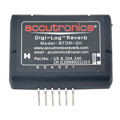

Recently I ordered an accutronics chip, if anyone has some design for it?
