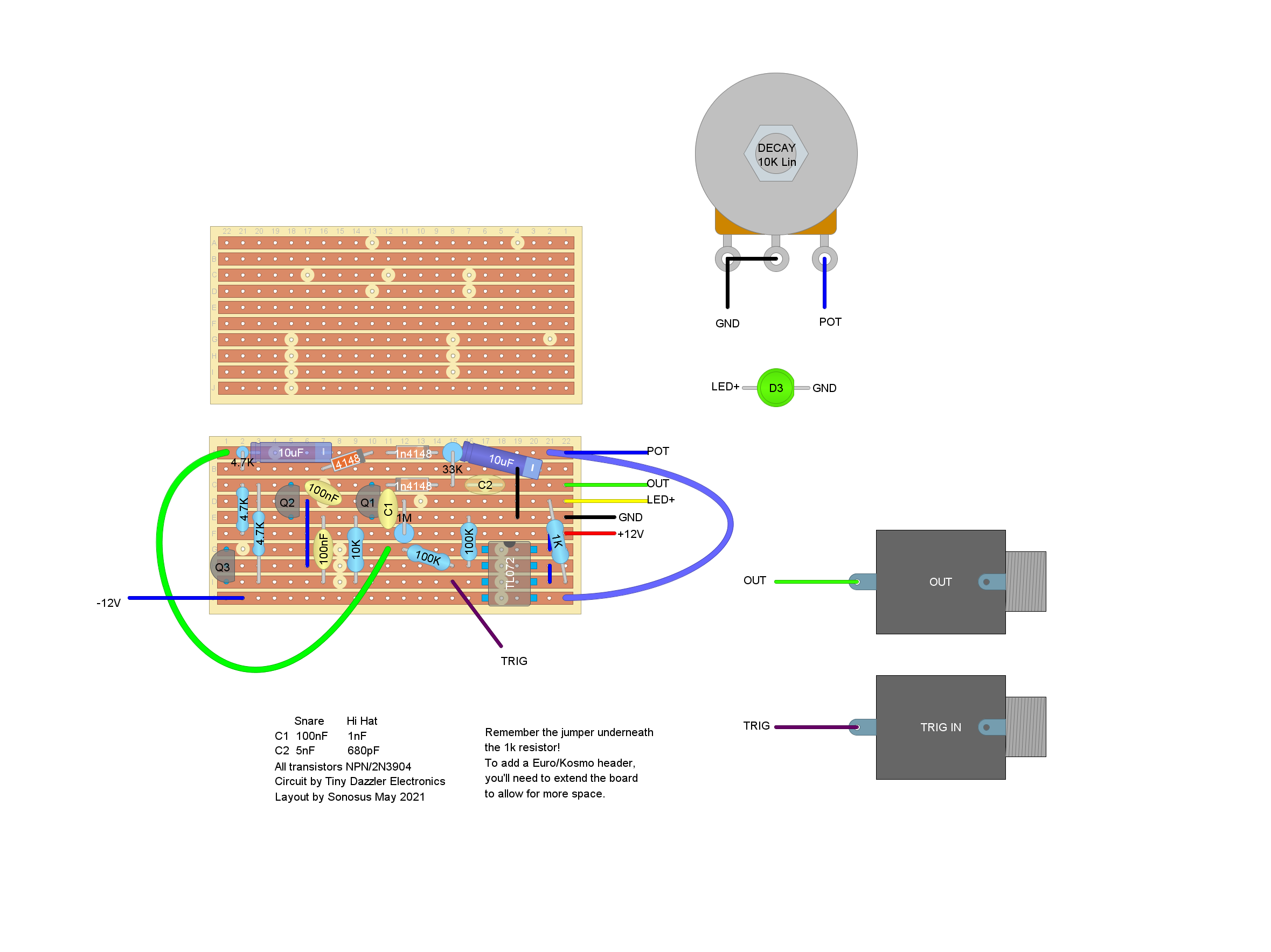

M4TM bass drum verified stripboard… Juanito ? The tin can modular guy, verified in my rack , more components than I thought but yeah not too bad bass drum
MFOS Sonic multiplier / ring mod…verified in my rack.
Stripped down version omitting sine wave gen ( requires a complete resonant filter
) and omitting cv inputs. Very nice Harmonic mangling. Not fully tested capabilities, I m pretty sure I tried a direct input guitar and there is enough gain for that. Sorry no demo but Easyish build . I think the trimmer is for gain matching on one input . Check mfos original docs but It will become apparent and hassle free should you make no build errors
As3360 dual vca VERIFIED. In my rack. Schematics and groundwork from kassutronics. Without doubt if I need another vca I would build this . Due to the nature of pin i/o this turned out to be a very tidy and small build . Recommended
Bias can be omitted if you dont want extra control)

@Unauthorised_service, nice job ! just a small remark if I can, maybe it would be good to add capacitors to the power rails and also bypass cap on the + & - of the ICs
Sure… I have certainly gone and retrofitted some caps On a few modules to bring noise down to an acceptable level.
btw I check the original schem (Mutiplier) and there are these caps
Crikey thats a lot … yes put some of those in is recommended
Well, six of those 100 nF ones are for the three op amp chips in the sin generator which you omitted…
