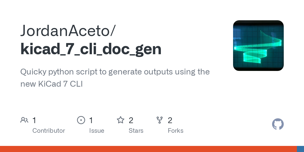

Fairly nice as it is but I’m working on improvements to make it faster and more flexible. (Early days, where by “days” I mean “day”, but you can take a look here: GitHub - holmesrichards/kicad_7_cli_doc_gen at rsh)
