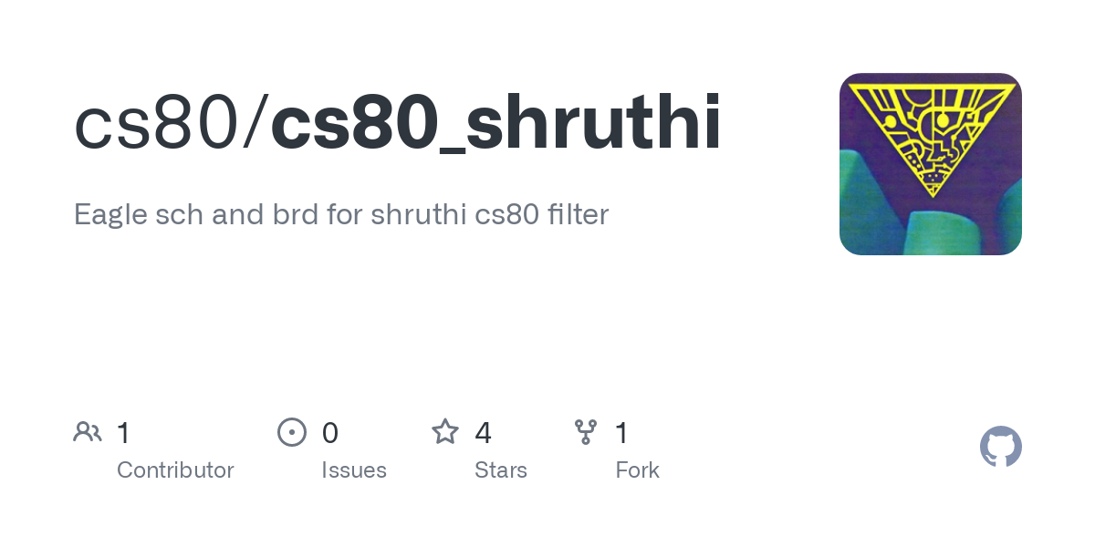

It’s open source, repo here
so if you wanted to do some modification of it you could start from that.

How would I be able to view the files and edit the pcb layout? I’m kind of familiar with designing and uploading designs on easyeda and pcbway, but not exactly with the files the github link has?
I think you’d need to be a little careful here - the filter cards are for the Shruthi - which doesn’t really follow eurorack/kosmo specs, and some communication may be digital from the Shruthi main card. The filter core, however, may be more or less easy to extract from the design…
