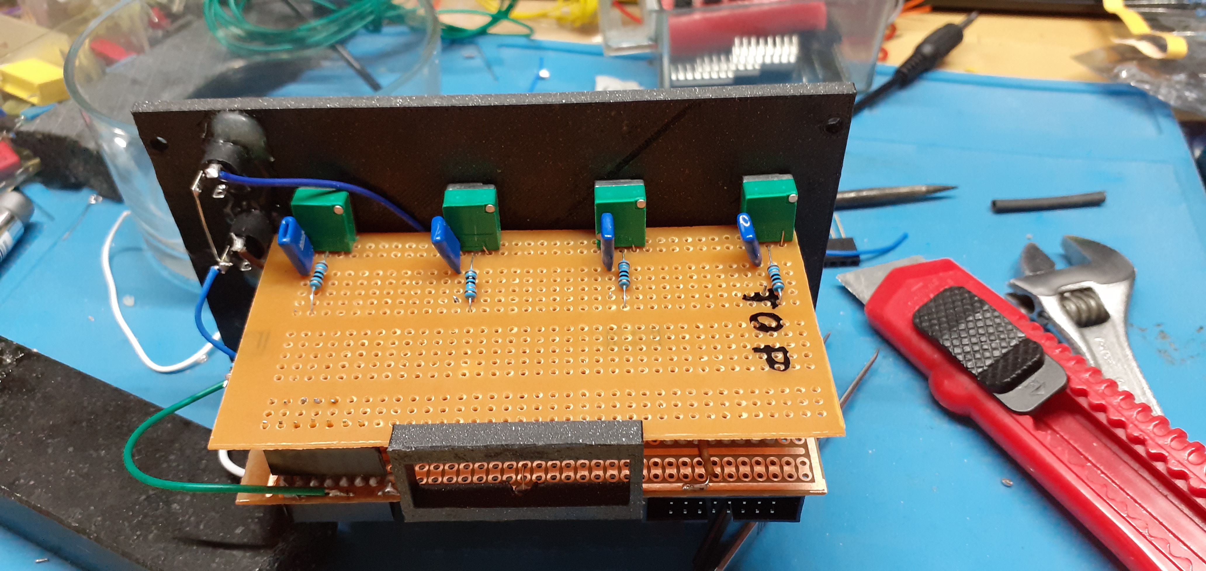

I see a Daisy Seed, what could be a quad op amp, a couple of trimmer pots, another couple of pots, and two more devices at the top that could be audio, and a sprinkling of passive components. And in pride of place you have a miniature breadboard.
I think you’re building a digital semi-modular using the breadboard as a kind of patch board.

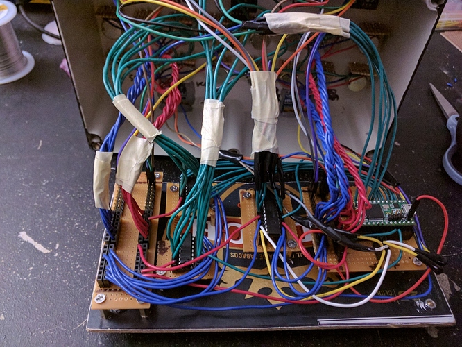

Progress is slow, but mostly due to motivation. Corralled the cables, all hooked up right. Prolly not going to go with this method again. Its a bit too impermanent. I should be able to get everything in there without it popping loose. Not too big a deal since this is a prototype. Once i get this on pcb it will be a lot better.
The good news is all of the serial devices check in, so thats one worry i can put to bed. I know the cabling could have been simpler, but w/e.
Now im off to code the firmware for this thing. I have tested these in different isolated instances, but you know its a whole different thing when you do it all together. Im looking at all of those unused pins on the arduino and shaking my head. I COULDA ADDED MORE INPUTS!!! If i could only fit them in this enclosure…
Seriously, the MCP23017 could support 3 more rotary encoders, 1 digital, and 10 analog pins on the Teensy 3.2. Id be curious how much delay there would be adding more MCP23017 and how much that delay can be alleviated by using the other hardware interrupt. Im thinking this isnt nearly close to what you can push out of this thing.

So rad! Certainly is a lot of wires
Get a Mega Pro, then you have even more inputs unused you could use

Number of inputs on are less important than the brain. The teensy is just better for my application than the arduino.
This can work with an arduino nano, but i would need to use midi 5pin din and power via usb, and the speed might bottleneck. I am considering a variant that uses a nano to reduce costs though absolutely, since thats what I used before in v1.
Sturdier case! But yeah, hopefully wont sit on it until after i get the firmware written and am happy with it at least.

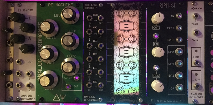

Made a protection/travel case for my SHNTH and a Pedal.
Also built this Little Mix from Analog Ordnance (far left)

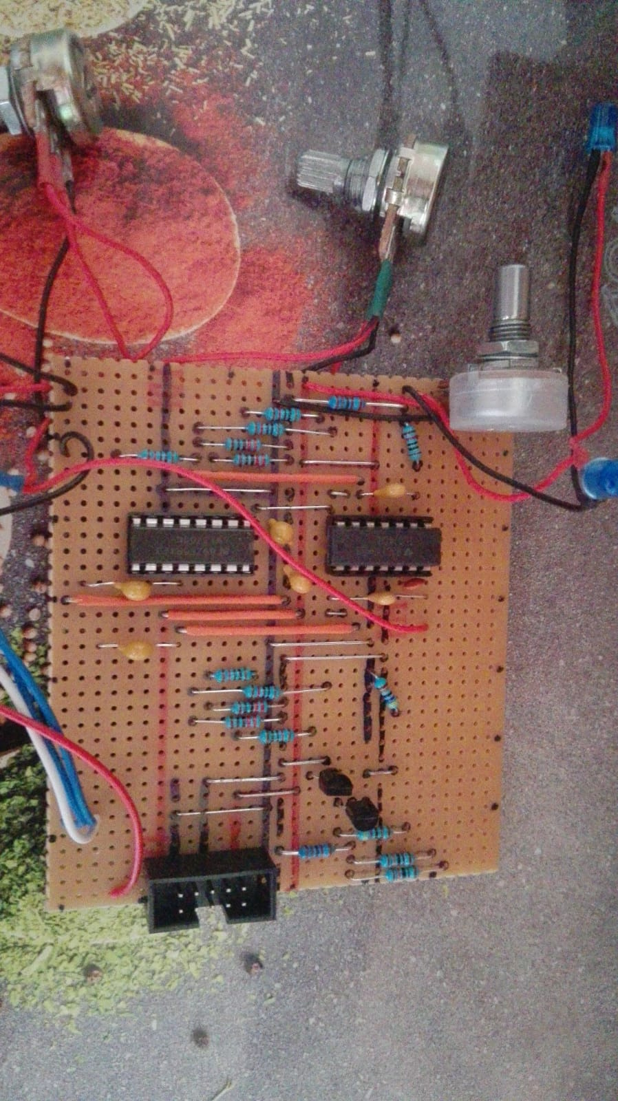

What’s that in the background, a SPICE simulation?

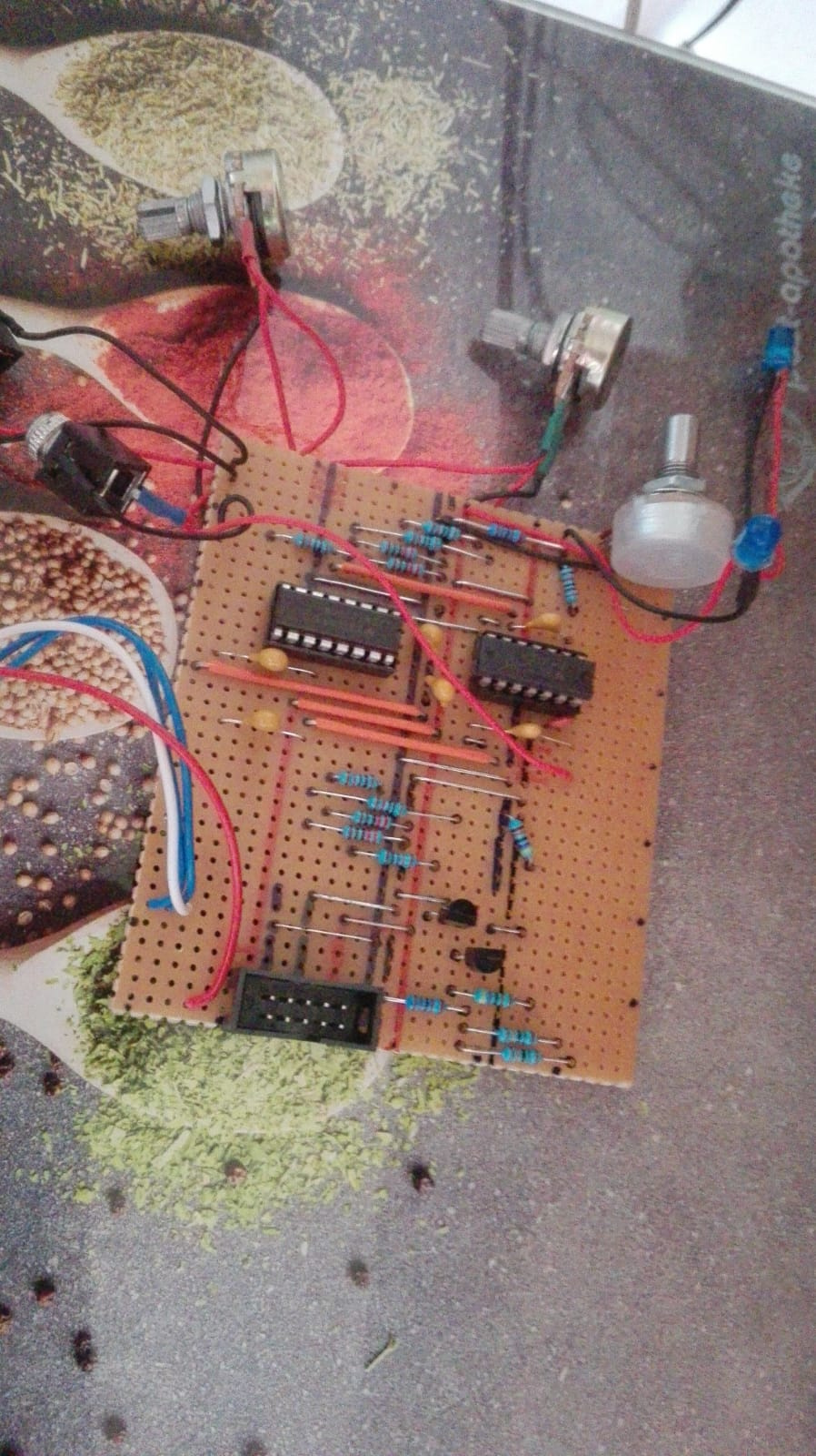

This is a cutting board made of glass with these motifs on it. Is very practical as a soldering pad, etc.
So to be absolutely clear, you didn’t just lay out your finished module on a worktop strewn with nutmeg and whatnot? It’s actually a trompe l’oeil?
