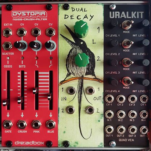

I have finished the wiring and testing of the 8 Step Sequencer. I used Eddy Bergman’s circuit diagram. Features individual step CV control, step speed control and number of steps. Enjoy.
Eddy Bergman’s page : Eddy Bergman.com: Synthesizer Build part-8: 8 STEP SEQUENCER.
My girlfriend painted a frontplate for me. Thick watercolour-paper glued onto a aluminum plate with lacquer on top seems good enough. I don’t actually mind if things get worn or scratched, it just shows that they are used and loved. When buying used gear, especially guitars, I don’t trust if the instrument shows no marks of usage. It’s probably not a very good instrument if it hasn’t been used much.

Now I integrated a VCA into my case !

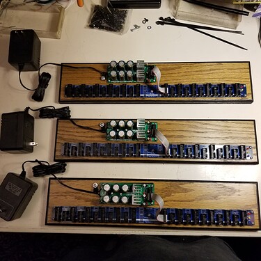

3 new power supplies ready to sizzle …
