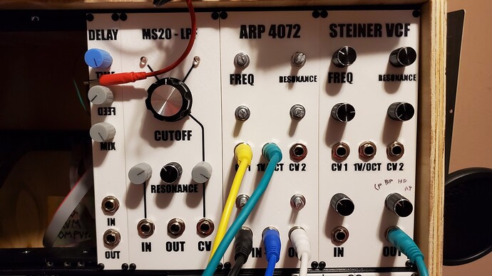

The Yusynth ARP 4072 is finally wired up. Man that was a lot of wiring! I still need to adjust and tune it but it does appear to be working. Doesn’t seem to have as much resonance as the MS20 or Steiner but does still have a nice sound.
I’m glad I built the MS20 first, it seems to be the most well rounded of the three and the simplest to build - though it does sometimes lock up on strong signals. The Steiner is the “hottest” and may still need some tweaking - the resonance on it goes off the chart really easily. But being LP/BP/HP/AP it’s also the most flexible of the three. Really glad I built them all though as it’s neat to have them all next to each other and experience the differences and similarities in the different filter designs. Was also fun etching my own boards for the ARP and Steiner!
But you made the good choice to add a Attenuator pot for input, decrease a little for square wave and all works fine :slight_smile:
also decrease a little the input for others wave (less strong) add also more resonance :wink:
All my MS20 have it and it’s highly recommended.

Yeah, I didn’t have that at first and it was almost unusable. Thankfully one or more people on here suggested the attenuator to me and sure enough it solved the problem :+1:

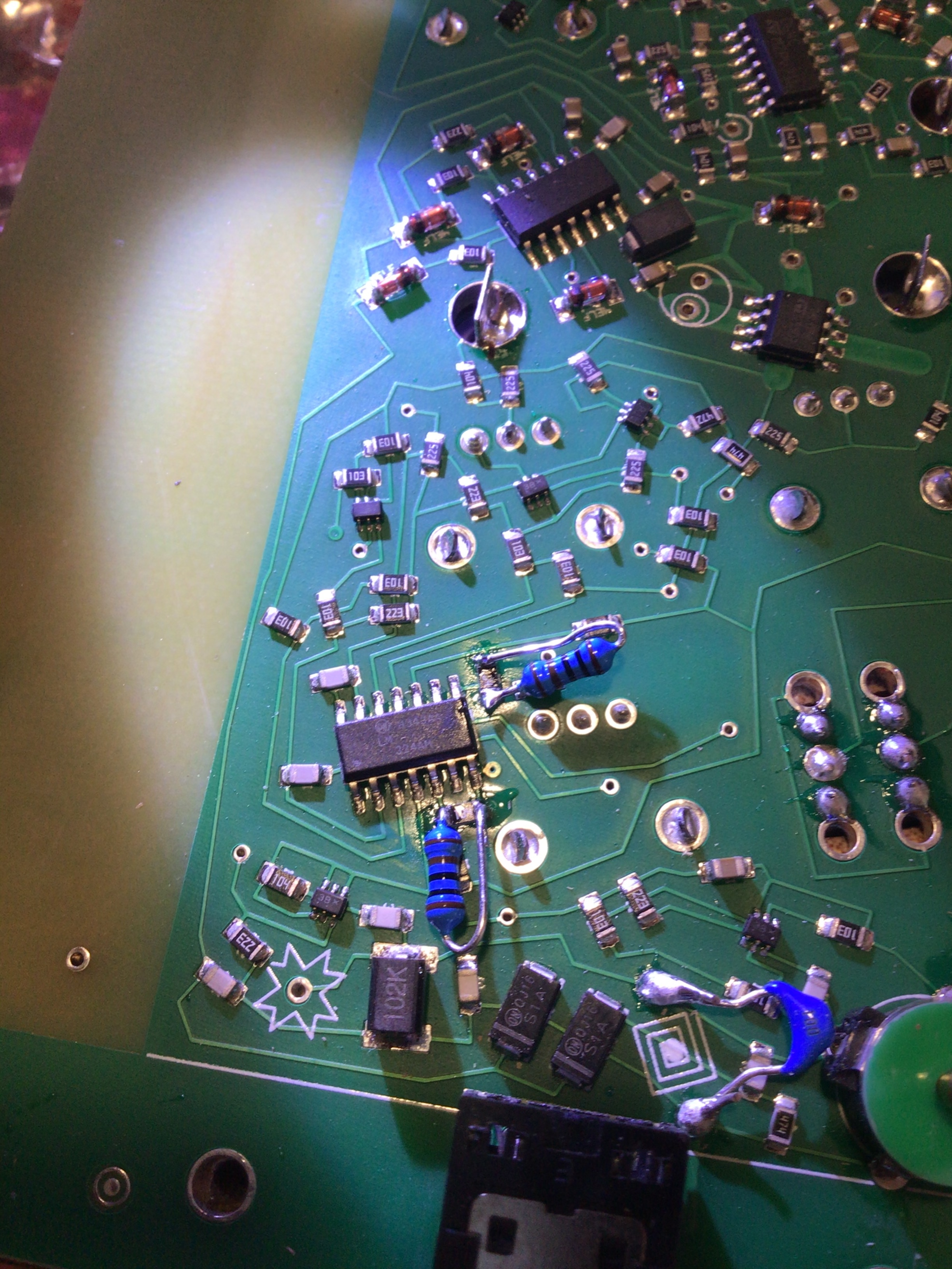

I repaired a Plumbutter 2’s AVDog Filter and modified the Deerhorn for lower tones by request of a friend in another forum.
Got the tones from the Deerhorn much lower than before :slight_smile:

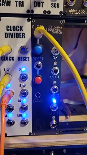

Feels good to be getting modules off my desk and into the case again:
Still need the on-off-on switch (should be here tomorrow) but @CTorp’s sequential switch is working.
Awesome! You’ll just be stuck in 4 mode for the time being haha
Nice putting it next to the clock divider. You can put your divisions into the sequential and the output to your envelope. Cycle thru manually or with a gate for fun times.
Also I think if you patched 3 to the reset you could get two steps without the switch
