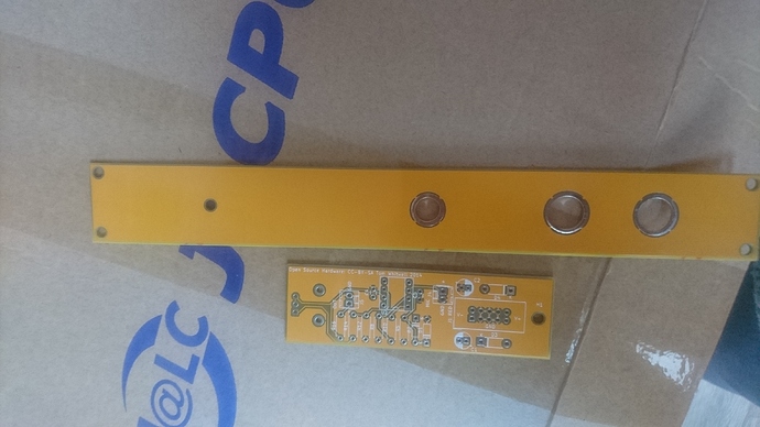

Give us a look will ya?
Thatâs really weird, shouldnât the front panel be the same colour as the pcb?
The PCB color is yellow solder mask on top of copper, the panel looks like bare FR4 (no fill, no mask, just the silk screen).
(or maybe it is mask on top of raw FR4?)
EDIT: Yeah, I suspect itâs yellow mask on raw FR4; white/black tends to be more opaque, and the yellow one is extra bad.
(Also, some random googling brought up https://docs.oshpark.com/services/afterdark/ which looks like an interesting option for stylish front panels.)
Huh. I thought I specified a copper layer under the mask on the front as well as the back. But looking again at the KiCad file, itâs only on the back. An omission on my part. Not that itâs needed electrically or anything, and it looks okay with the white solder mask. Anyway, just in case it ever matters, Iâll put it in. Sorry about that.
Yeah the OSH Park After Dark sounds interesting, if youâve got the pockets for it.
No worries, good of you to share your work in the first place., was not sure if I had just done something wrong.
Hopefully my own PCB may turn up tomorrowâŚ
Rob
Just checking⌠howâs the back of the panel look? There should be a copper layer there (@ChristianBloch soldered to it!) so Iâd expect it to be more the expected color.
Whenever ya fix it, let us know in your MikroKosmos post please lol
*nvm, just went to the thread and seen you already did
Good to know! âââââââ
That OSHPark place is SUPER expensive for KOSMO sized boardsâŚ
Not even their Afterdark service - 3 Braids Conversion Panels would be 132 bucks. lol

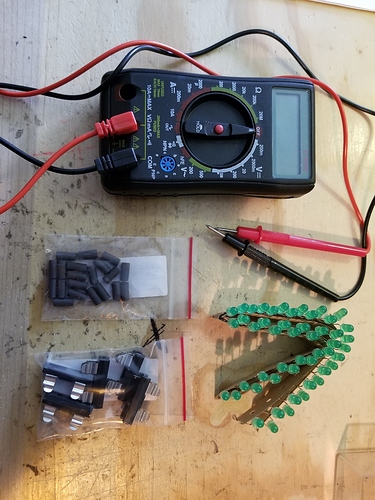

well something finally showed up . stuff from the surplus place , not really anything needed to finish the projects . well maybe the fuse blocks for my power supplyâs will help me finish those up . the funny thing is this was the most recent thing I ordered .
A cornucopia of chips, some jacks cause you never have enough of those, and some slide pots for fun. (and a fun little 3 digit led)
