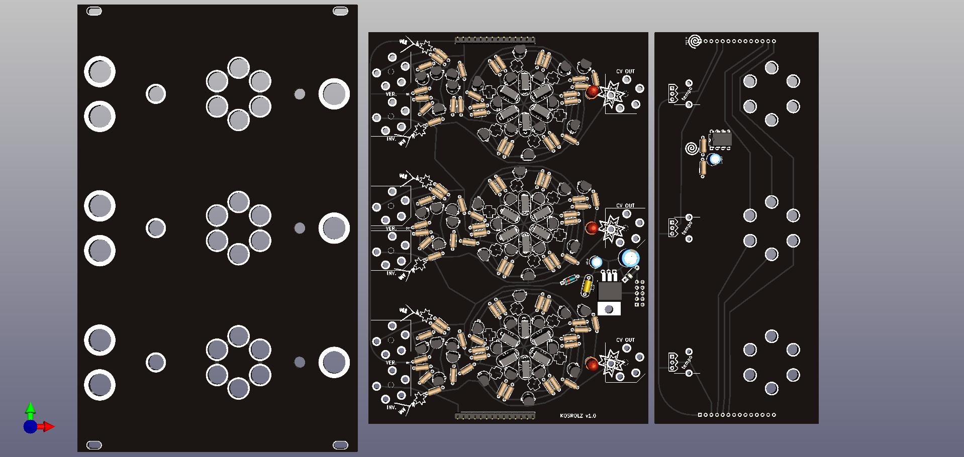

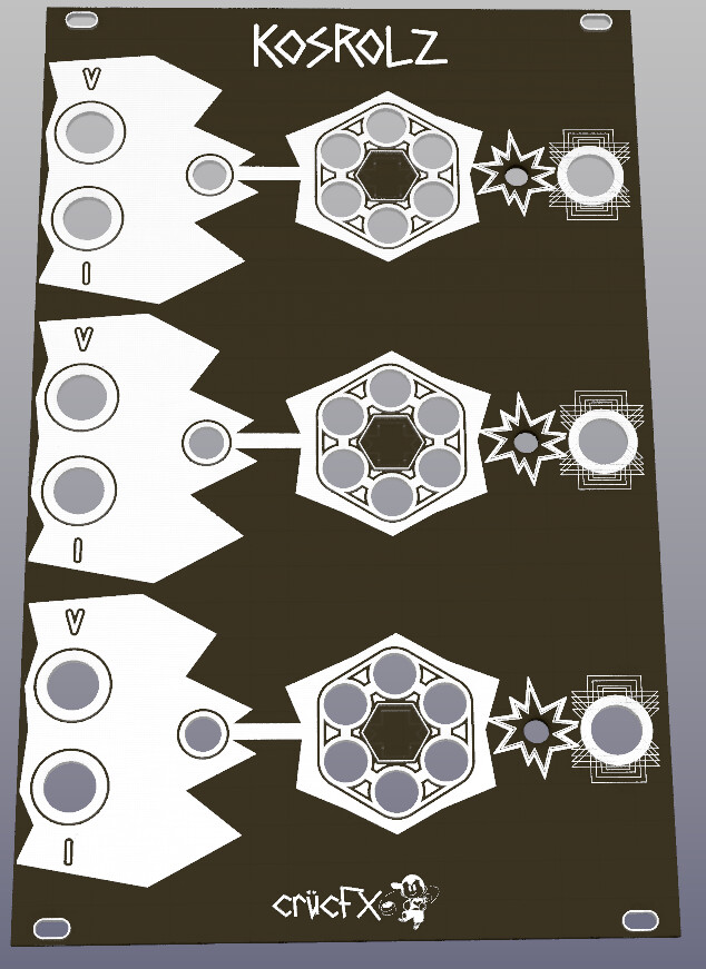

The idea behind it is three 6-node CV controllable Rollz with an extra DC coupled node per set to allow for 3 random CV outputs.
6 CV inputs - 3 Verso, and 3 Inverso (Positive and Negative)
3 Rate/Tempo Pots (mind you - these only affect it so much lol)
The three 6-node Rollz would be inter patchable with banana cables.
I WAS going to use 3.5mm’s, but I really do not want to risk someone patching an androgynous node to something Eurorack and frying their module.
The Rolz nodes themselves are purely negative spikes.
Hence the dc coupled CV output per set.
Just wanted to gauge the interest.
I’ll probably make it either way, lol…

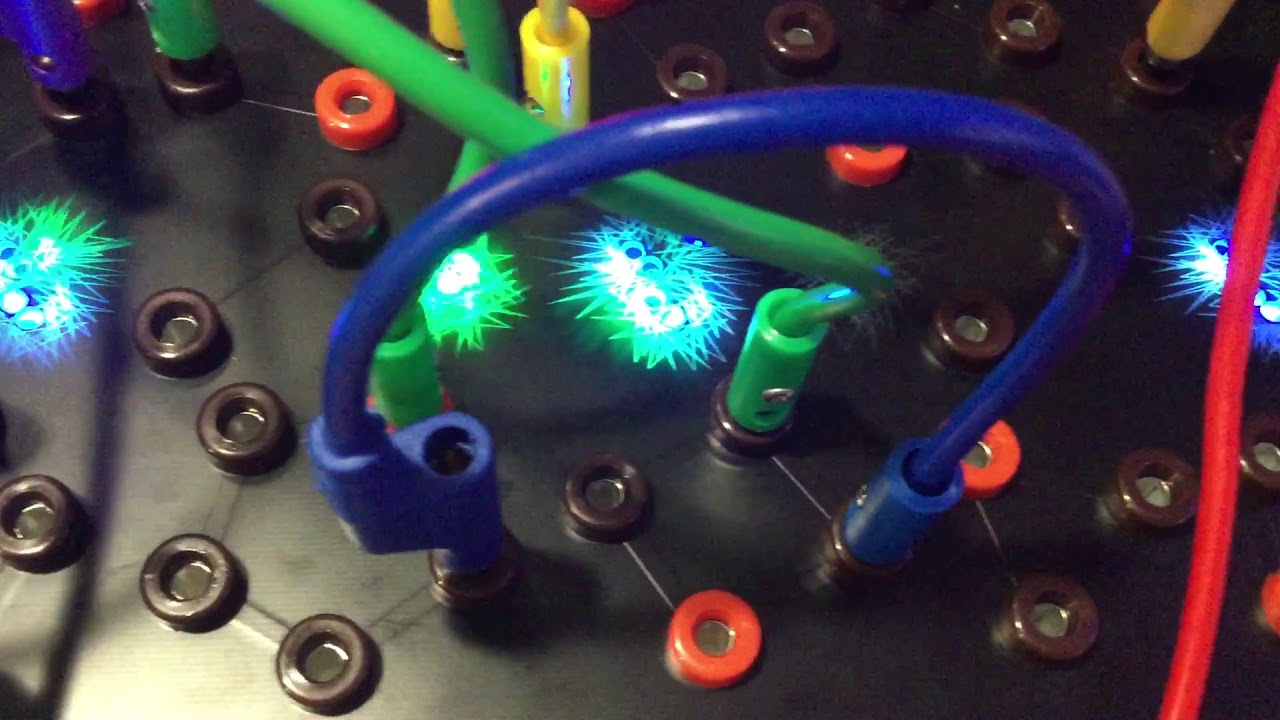

to give people an idea of how the random CV Outs and Patching can affect other modules - here is an example with my table top ROOLZR with Positive Pulse Outs running into my JMBLR and then into Denum by Ieaskul F. Mobenthey - controlling the Bounds and Bounce CV Inputs.

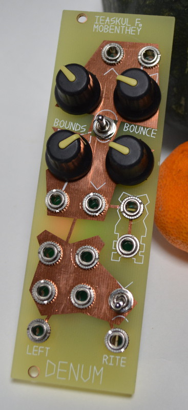

^ - here is a Denum.
Unfortunately JLC will not let me do bare copper… I begged… lol…
If ANYONE knows a place that will omit the plating step - please let me know.
Or if anyone can etch and silkscreen… lmk…
Would need the panels cut to tho… lol
