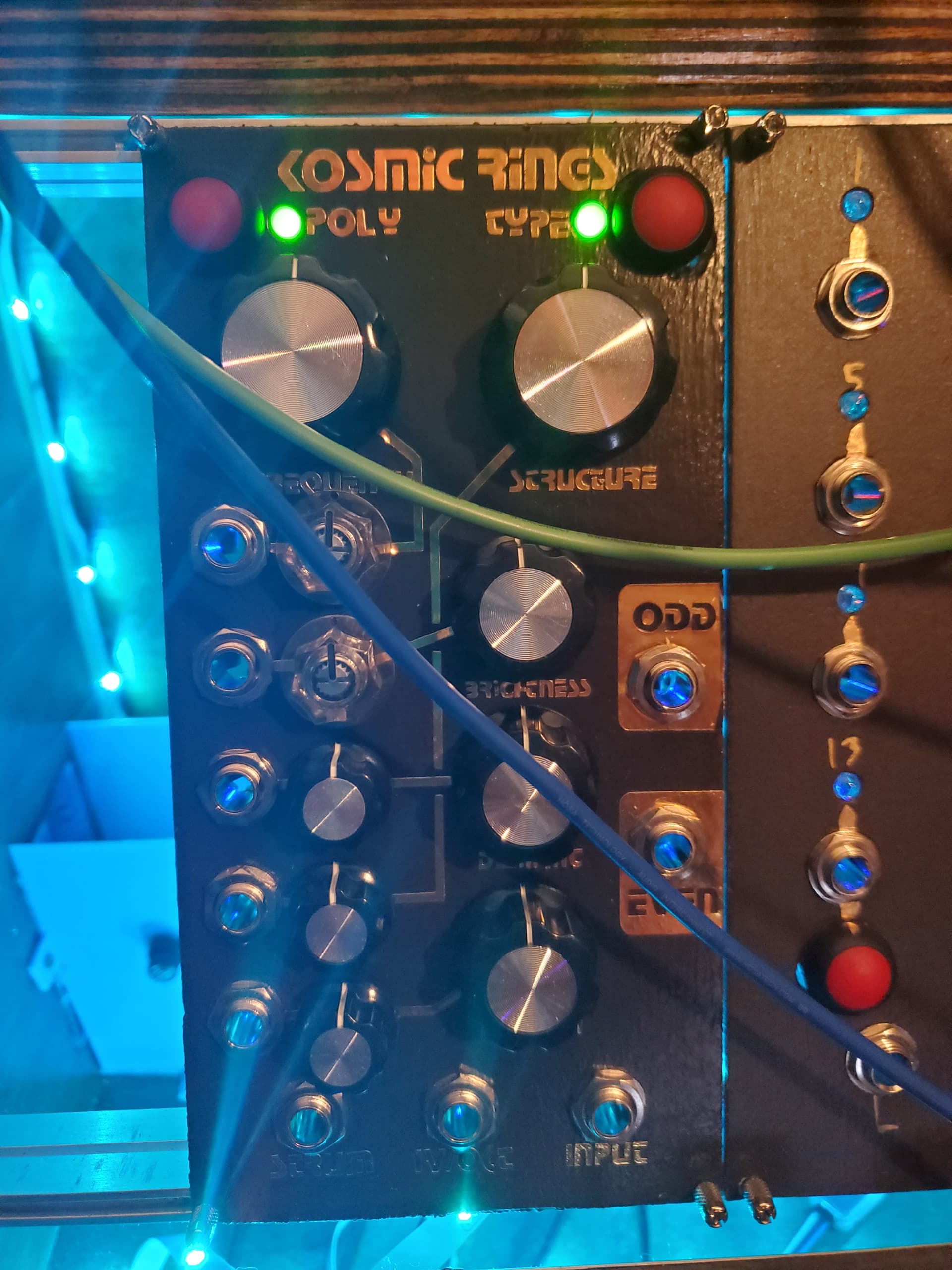

I did!
It is a DIY kit called nanoRings. It was just the board with the SMD components and the pots, jacks, and LED’s provided separately. Perfect for adaptation to Kosmo format. It’s one of my favorite modules in spite of being mildly borked right now. The attenuverters are not wired correctly so the CV jacks effect the wrong pots.
If I had to do it over again, I would have stuck with the smaller LED’s that were provided. I replaced them with similar 5mm ones but the brightness levels are off, so the orange/yellow mode is difficult to discern.
I also have a similar kit for nanoTides but have not gotten around to wiring it up or making the panel for it yet. I wish I knew onshape better so I could get a couple of milled aluminum panels made.
One mod I would like for this module is to have bi-colored LED’s behind the attenuverter pots for the CV’s controls. nanoTides has this functionality built into it - when you send it CV the LED’s shine through the clear shafted pots. I think it looks really cool and it saves valuable space on the panel. It is accomplished on tides with surface mount LED’s on the board positioned behind the pots. I’ll have to do some fancy soldering to break them out for my version and I’m a little worried I might mess something up in the process. The rings board on the other hand does not have that functionality at all. I will likely have to build some sort of parasitic buffer board or something.
