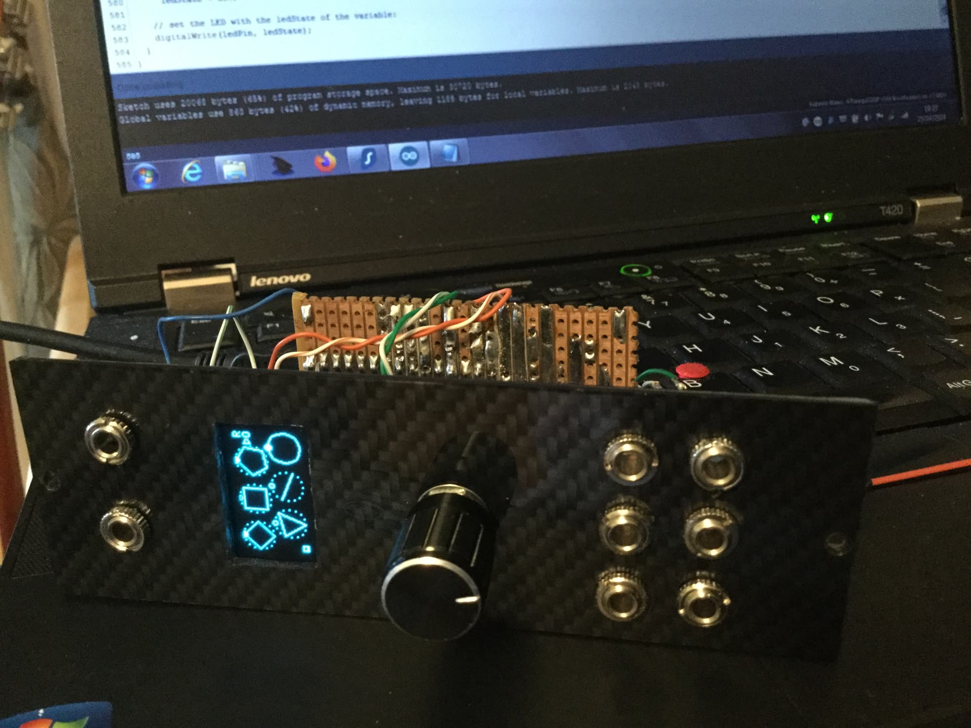

So… came across the ARYTHMATIC alt firmware with clock reset and flipped button/encoder
operation and certainly prefer this version. (by no means a critic of mr HAGIWO , far from it )
Also with the original firmware my encoder was skipping/missing values
However ,as is the nature of these things , Random Occurence select was not working.
I confirmed this with meebilt on YT who experienced same behaviour.
Pretty much a complete novice with coding ,but can work out how to adjust some variables.
Anyway managed to work it out .
some notes…then full code… I have adjusted the random values also …thus :
