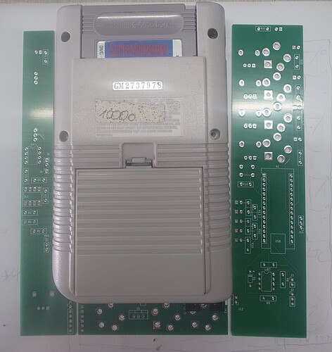

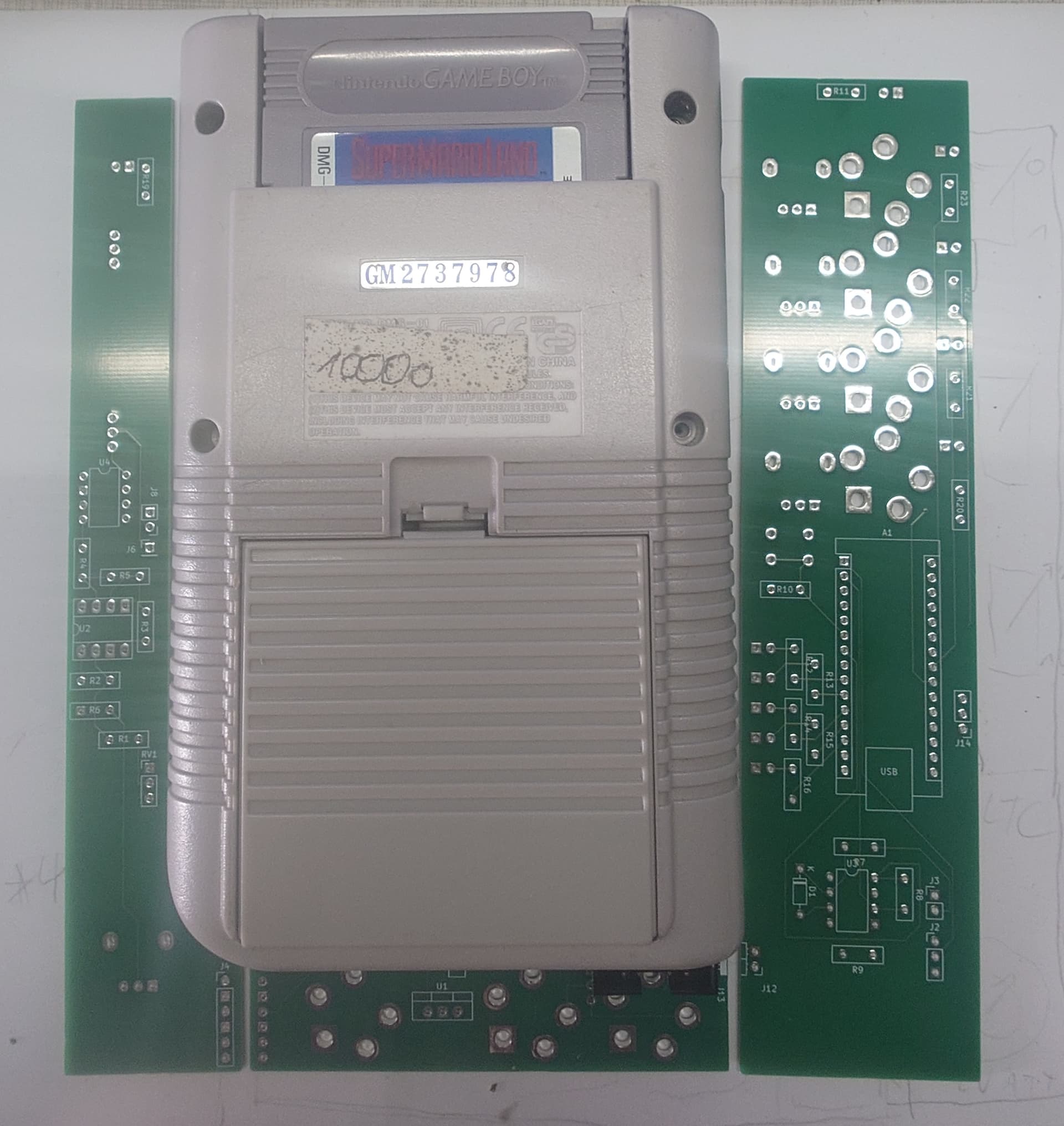

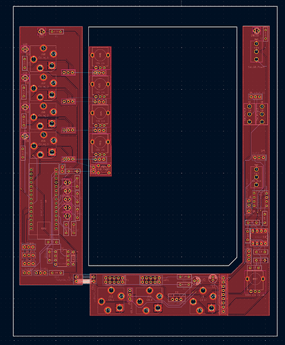

This is a 15cm module, 5cm for the arduinoboy and 10CM for the gameboy with mod. the idea is to add two more gameboys later by leaving out the arduinoboy pcb and use a smaller face plate with minimal modifications to the project.
Sadly i got no feedback but i pushed trough anyway… the boards are currently produced by JLC. we’ll see how many errors i managed to build into it… the first one to guess the number (of errors) correctly gets a free copy of the module once it is working…
I’ll say three - but I hope its less :wink:

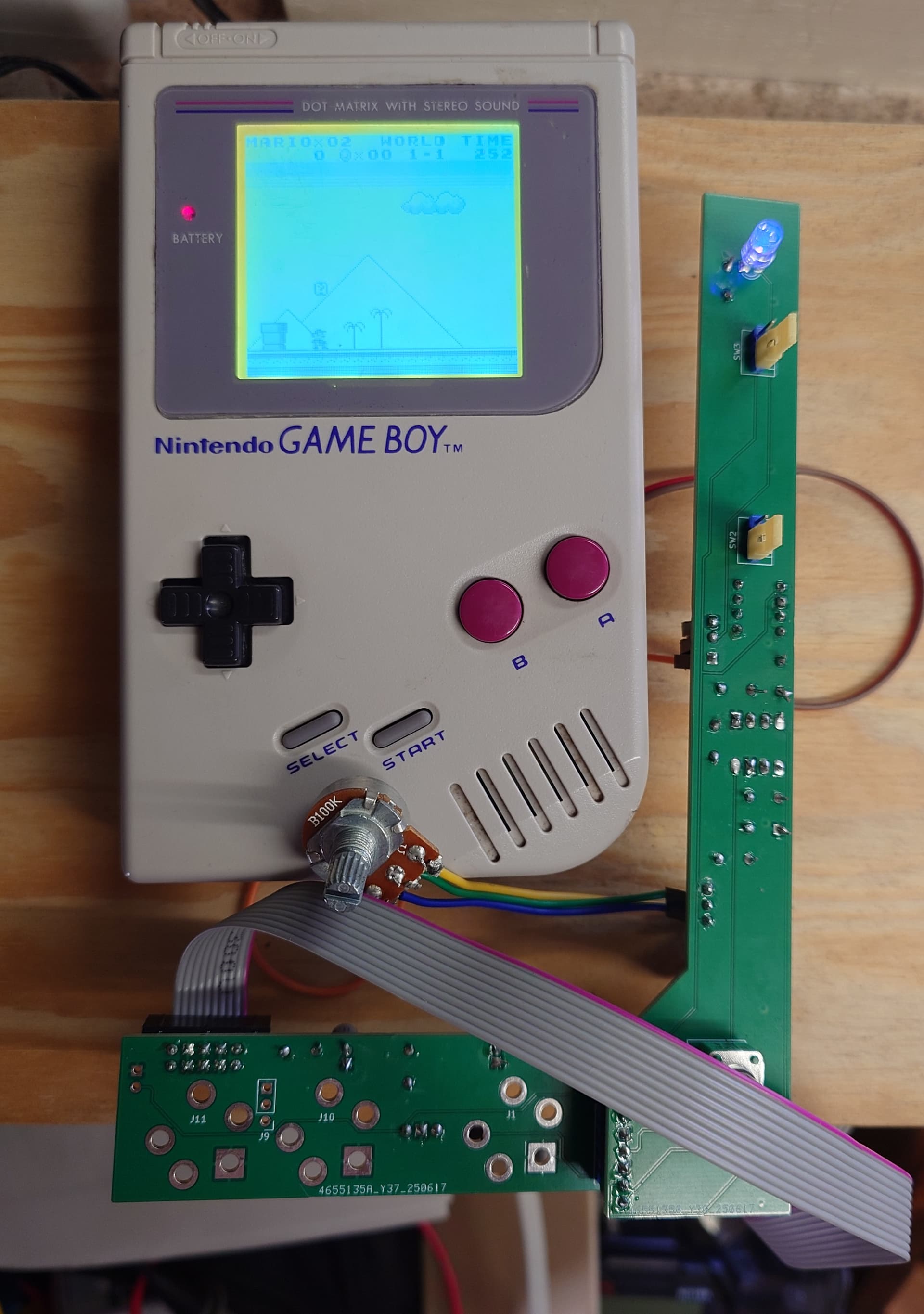

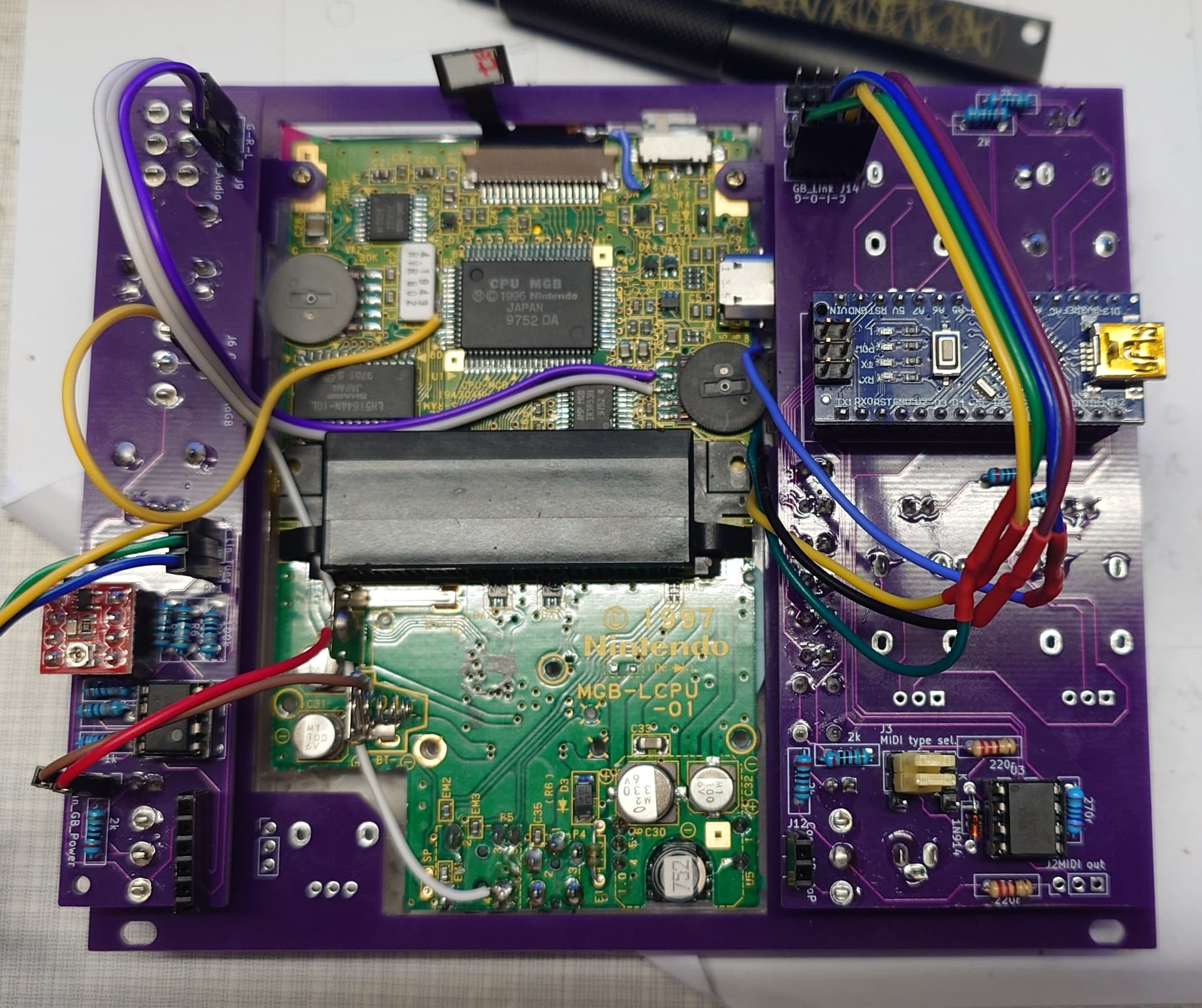

the CPU-mod seems to be working… i had ONE (functional) error so far… next up the arduino boy
i am still testing the arduinoboy but i think this is working as expected. no additional functional errors in the pcb design (not 100% sure on that yet). there will be many improvements in the second itteration, mainly better footprints and optimized positioning.

so close… i thought i’d have this thing runnign by now… link cables, why are there so many variants? i got the wrong one… i have to wait for the correct one to get delivered… next week or so :frowning:

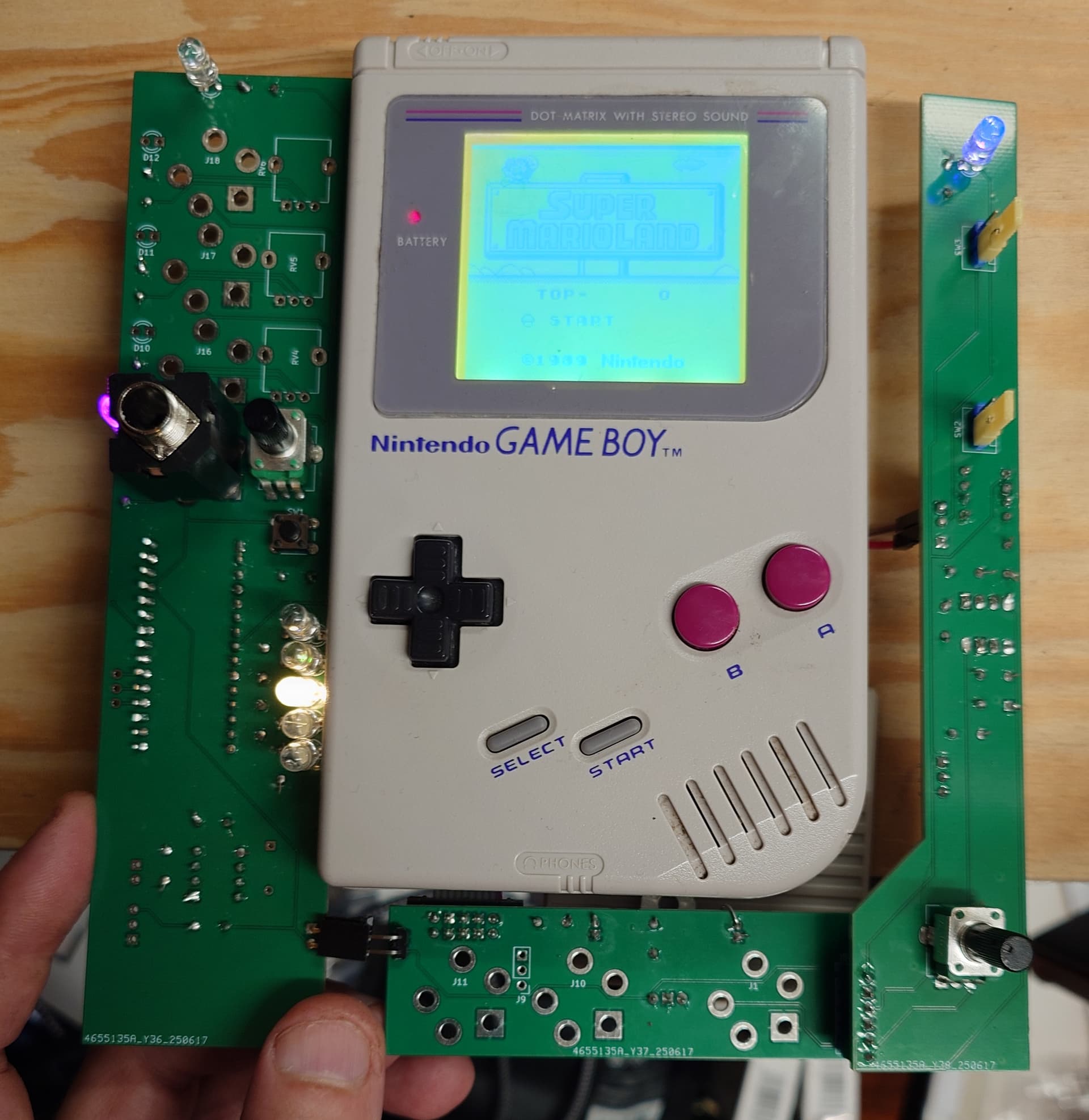

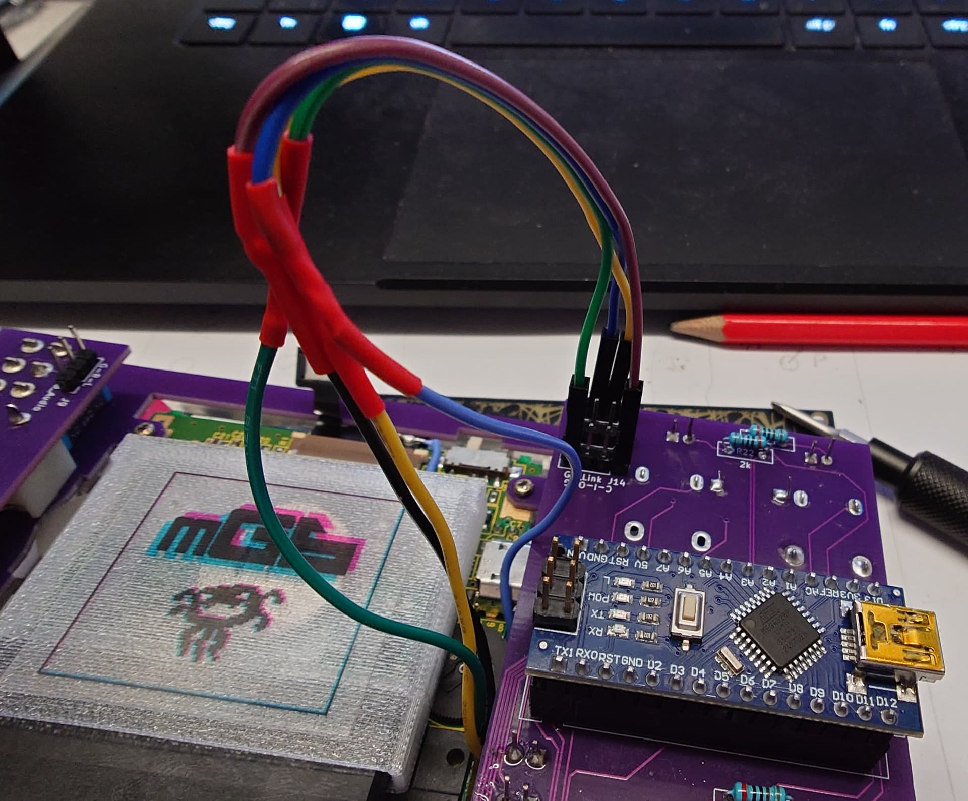

I am gaining confidence that my pcb-design is working… the arduinoboy behaves (blinking on button presse) similar to one i bought off the shelve (catskull).

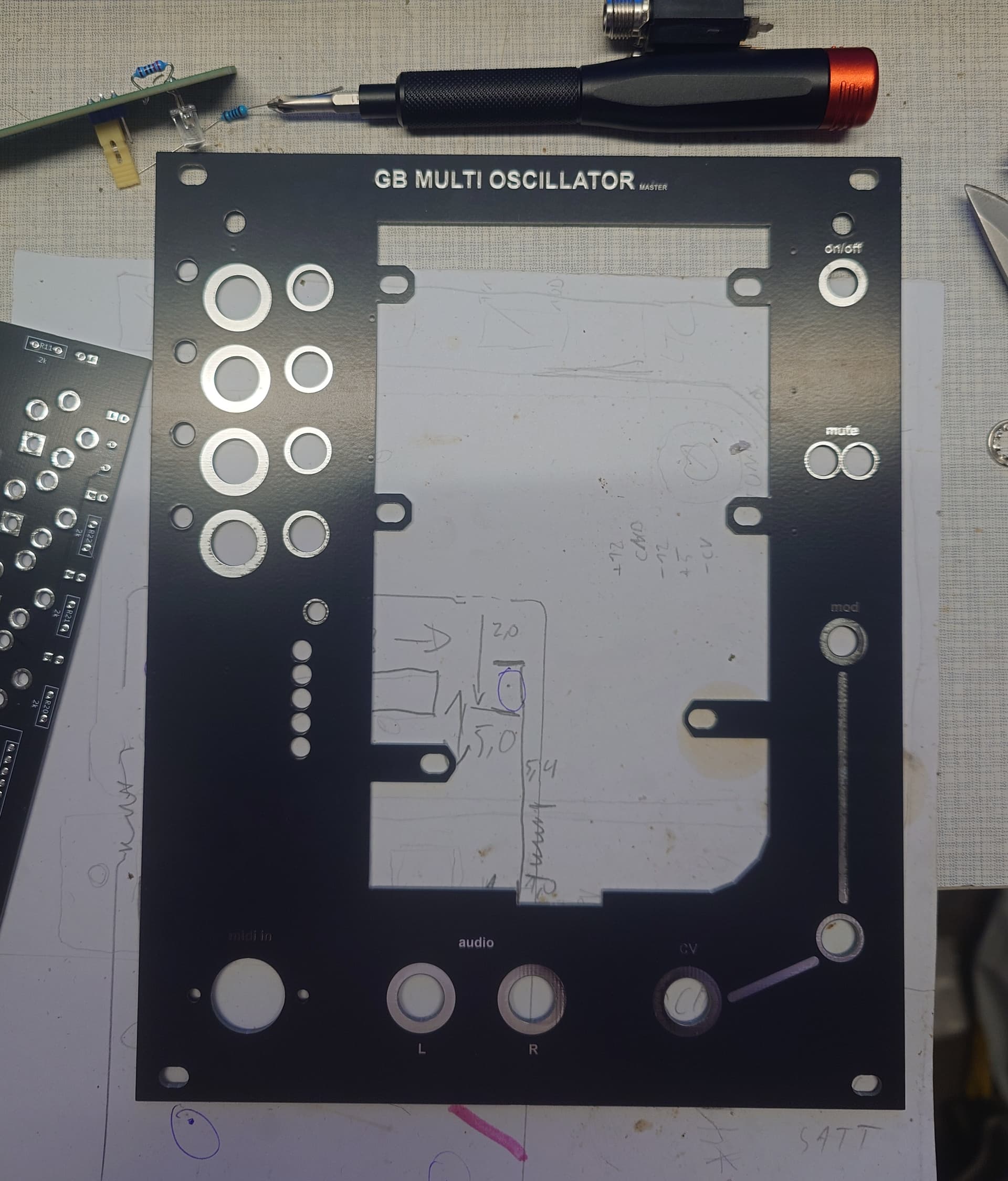

i’ll start designing a face plate…
improvements over the last itteration:
  • pots raised on daughter board
  • mute switch(es), still searching the correct footprint for a SPDT (<=?) switch
  • secondary power connector to daisy chain the modules
  • optimized placing of multiple components (LEDs, Switches, Power connector, …)
  • the modules will be 16cm for the master an 12 cm for each extension GB, that meakes 40cm for a complete triple osicilator

there will ba a third and hopefully final itteration… we are in business :slight_smile:
pitfalls and learnings: trs midi… :frowning: , patinece…
Oh man, I’ll buy one of these as soon as they’re available!
We are getting colse… still some final test but i think we are ready for the release (of the gerber files), expect them within this week.

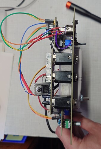

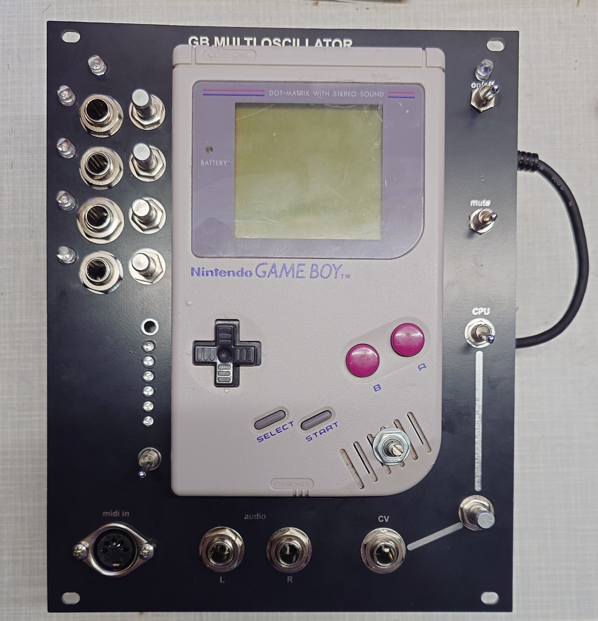

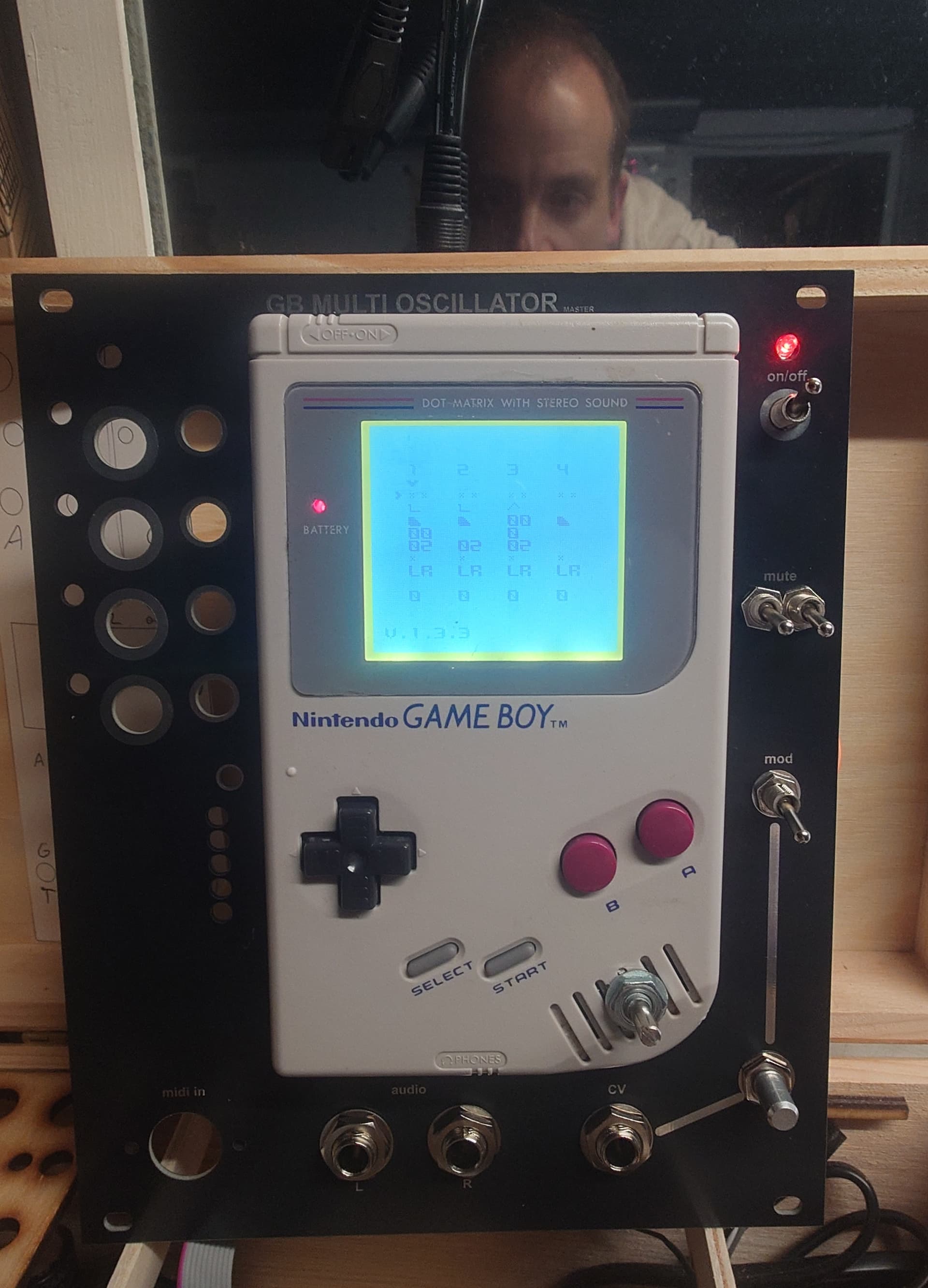

this is the EURO-POCKET EDITION of the GB MULTI OSCILLATOR. it has all the features of the original version. the most important change is: it fits into a eurorack case. this is the first “working” prototype, i’ll update the gerbers and documenation (^^post above) once i’ve tested it a little bit more…
UPDATED and RELEASED :check_mark:
next up the GB-COLOR version…
EDIT: more pictures & release

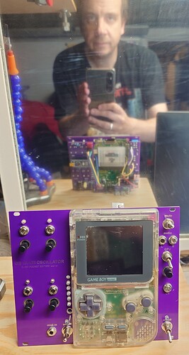

This is incredible, thanks for sharing your work. I wish i had started after you had posted this, but thanks for the inspiration to finish my own build - way too many wires and a PCB wouldve been much cleaner - the rear of this is embarrassing. - the beach scene was added thanks to @sebastian detailing the CV inputs
