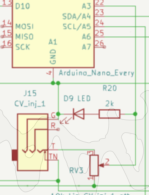

i am staying on thetopic of game boys. i think i can fit a gb pocket between eurorack rails…
this is going to be tight, i already ordered a (custom made) shorter mgb card. the cv injectors in this project need the switched jacks.
Gameboy oscillator documentation - DIY STUFF - Look Mum No Computer Thingies
this is the part of the circuit on the “big-DMG” variant. for the regular (non switched) connections e.g. L audio out i’ll use one of the available “simple” 3.5mm connectors.
i also thought about rotating vertical connectors, do the fit in the space usualy created by the height of switches and pots behind the face palte or are they higher? (as in too high to fit the nut on pots and switches)
