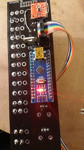

I was so proud of myself for getting my first set of SMT components on my board for an STM32 Nucleo based ADSR generator project I’m working on:
But… finished it up and plugged it and blew up a Nucleo board… what?!
Double checked all the power/ground connections, no shorts, nothing weird happening there - checked the rest of the circuit - weirdness from the STM32 DAC out to the S&H chips.
Turns out, I’d breadboarded this thing with LF398s in DIP8 and drew up the schematic from that. But as I was laying out the board, to try and get clever and keep size down I switched the footprint to SOIC14.
Don’t really know what I was expecting - the TL074 DIP and SOIC have the same pin out, but it’s not the case for the LF398. What I ended up with was the DAC pin of the nucleo connected to the -ve supply pin of the three S&H ICs - things get hot and then - bang - no more nucleo.
So there you have it, my entry into the hall of dumbassery. It’s not the first time, and I doubt it’ll be the last.
