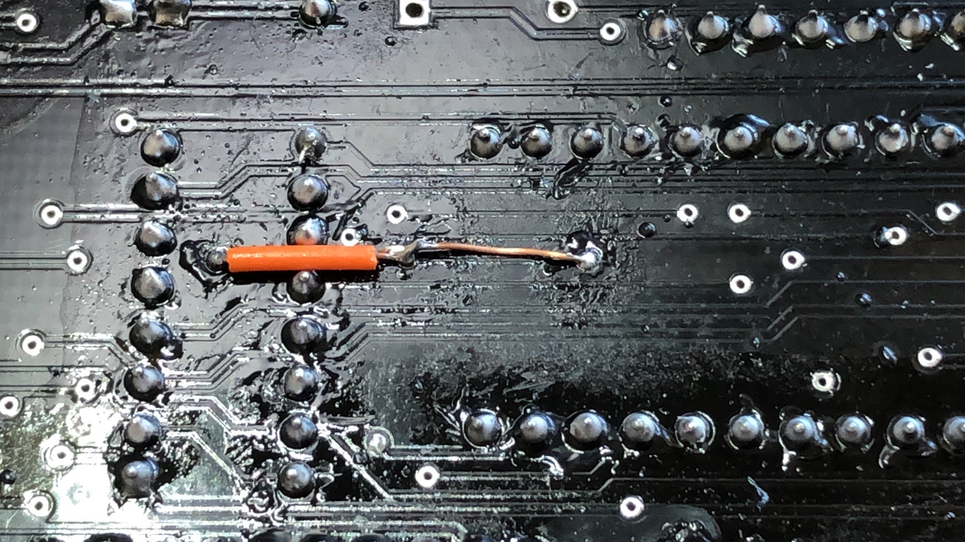

Found the photo I took of my repair, I got a blob of solder stuck on the underside of the board, and made the mistake of scratching it off (along with a track and through connection!) with my finger nail. Found a bit of bare copper wire in a cupboard, and used a bit of wire insulation to make sure it didn’t short out.
