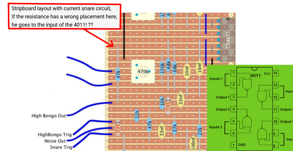

ERROR ! With “Part 2” of the drum machine, on the stripboard layout, the noise output has no connection to anyone! How is it to connect right?
greetings
There’s no mistake i think, the noise output is add to bongo to make a snare sound watch the video for explanation :slight_smile:
Yes you are right, but how embarrassing of me, only now see that Noise has a connection to the outside world with the 15k resisted, sorry!

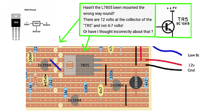

Hello dear people,
someone might tell me how I can hear the snare sound, he had explained it in his video, but unfortunately my English is very bad, can you explain to me how I should patch noise out etc.? … Isn’t the L7805 the wrong way round?
Many thanks in advance
There’s a lot of videos in this thread so not sure which part of which one you’re referring to, but the snare output is a mix of noise and bongo; from the article:
See the circuitry around TR5 on page 326.
Hi Guys,
i’m sorry but i have to ask some stupid annoying beginner questions again!
Please take a quick look at the pictures, there are two questions for you!
Also the question, can I only play the high bongo or the snare or can I play both separately from each other? I put the “Noise Out” together with the “High Bongo” in my mixer / amplifier and thus get my snare sound, but then I no longer have a “High Bongo” available, unfortunately my noise sound is quite quiet, it can be in the video Snare more convincing, I think I’m doing something wrong!
