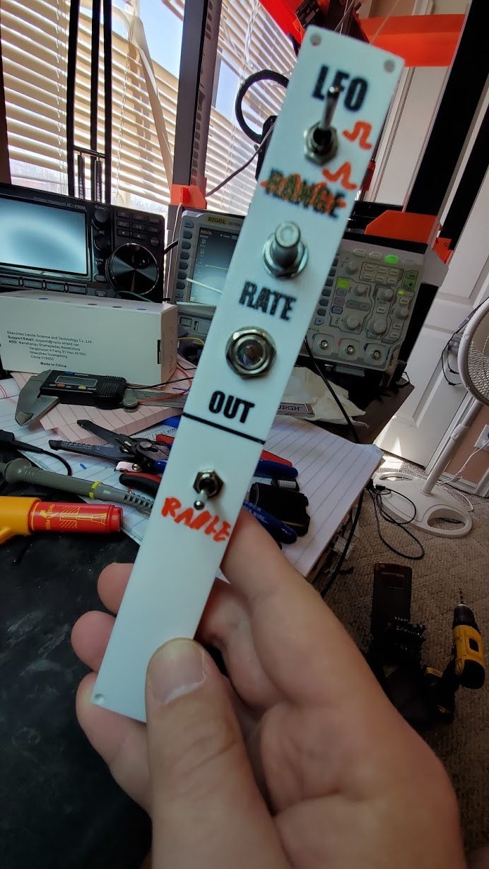

Hooked it up to my oscilloscope first…and…it works…but it’s not exactly a LOW frequency oscillator. The lowest frequency I was getting out of it was about 40hz. And using the range switch it sometimes freaks out and stops oscillating all together. I tried removing the electrolytic caps I put on the power rails just in case somehow that could be causing a problem (though I couldn’t think of why it would) but sure enough it’s still acting the same.
Oh - I also messed up and forgot to include the Waveform switch on my panel ( I decided to go with a switch rather than two jacks…but may change it to two jacks) and wired what I had labled as range to the waveforms. So had to make some sharpie and drill mods to the panel.

If anyone has any thoughts on what I should look for on the LFO or Snare when I get to debugging them this evening I’d love to hear it!
