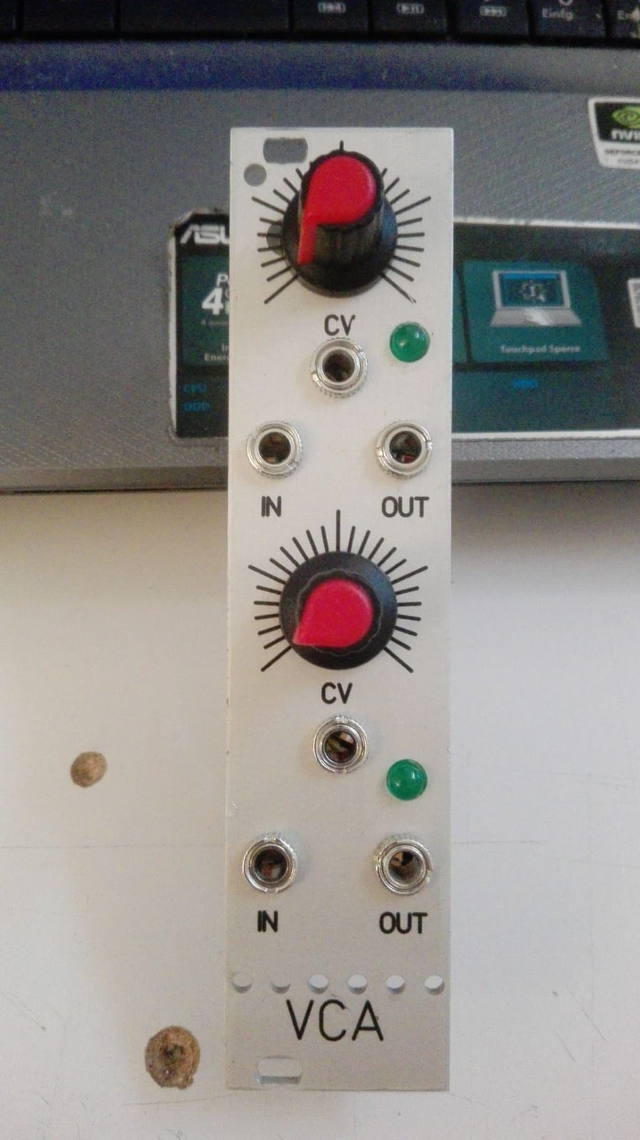

I like the way you fit two slews in the one panel - my first attempt at a dual slew was a fail. So this time around I went simple.
thx ! yes the holes slightly diagonally so that everything fits

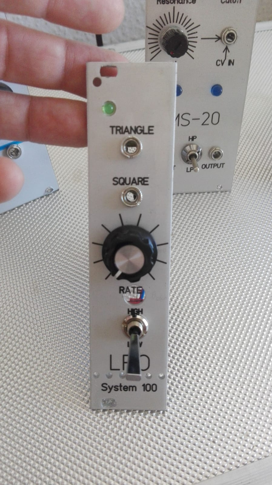

Soo, 3 days later, I’ve tinkered something. I redesigned some of my 80mm wide plexi glass panels and made them 50mm. I still had 3 smaller ones, there were already holes in them and I made the best of them. These are my first attempts with aluminum panels and I think they turned out quite well for that.
The first module “lowlow” is a simple op amp to attach the Korg Volca sample to synth volume. Then a simple VCA from the CUSI Sound YouTube channel. The Roland System 100 LFO (very simple). In addition, the core of Sam’s 3340 VCO with a few tweaks. And finally Rene Schhmitzes ADSR. Tomorrow I’ll screw everything into the rack / case and then it’s finally time to play!
I almost forgot the module, it’s Sam’s MS-20 filter, I built it 3 days ago
Well, by saying that you missed the opportunity to sell them as ‘ventilation holes to cool the electrons in the circuits in order to preserve the high fidelity of the sound’ (or something similar one always finds in HiFi magazines).
But apart from that they look really nice!
Those look rad. The holes make em even cooler.
