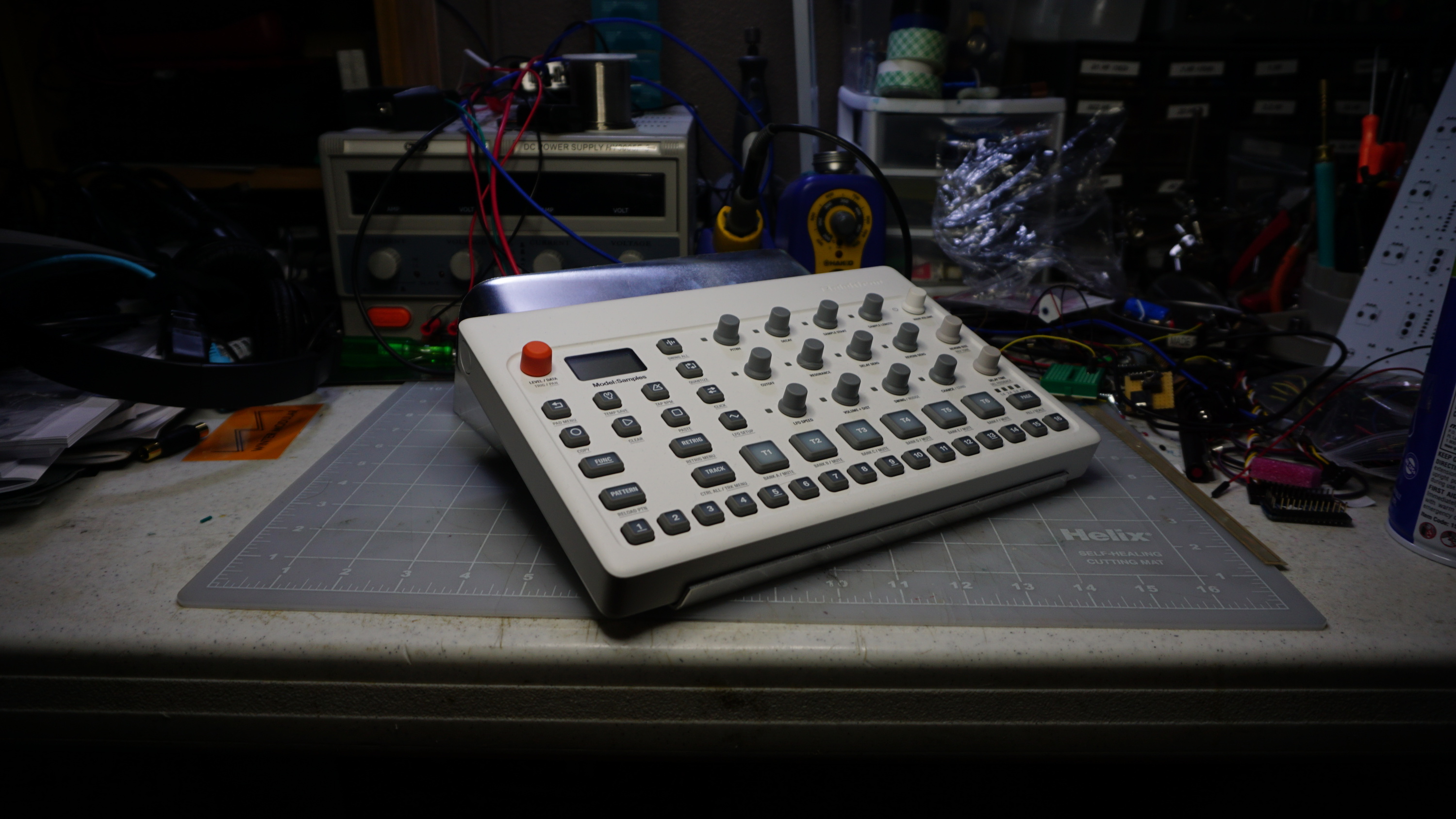

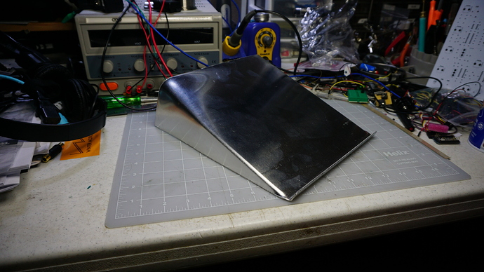

Metal braking is harder than it looks like it’s going to be
…but this will do the job I think:
(I actually made it for my RD-8 but that’s back in the hutch and hard to photograph, while this was light and easy enough to slide under it there.)

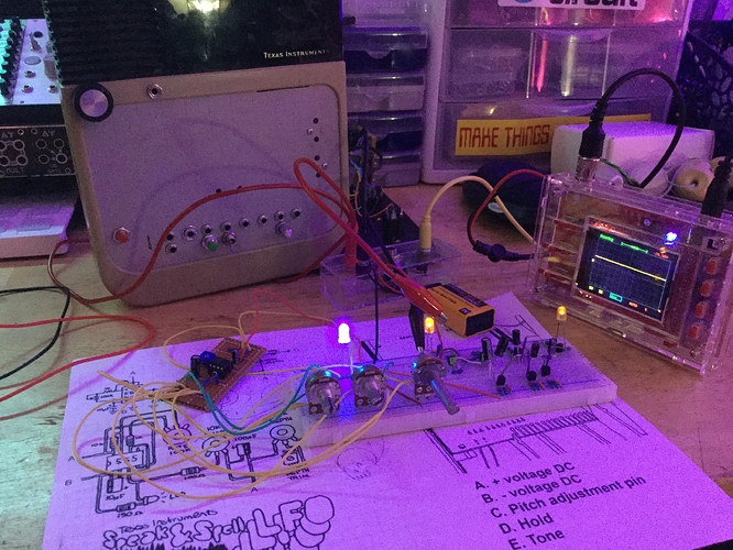

The math is apparently way more temperamental with an LFO… lol
Crashes almost instantly when adding it to its standard pitch bend sections.
Added some resistances and it was neat for like 5 min… lol.
Had to keep hard resetting the poor thing.
Will try it with the Read… maybe time to buy another spell lol.

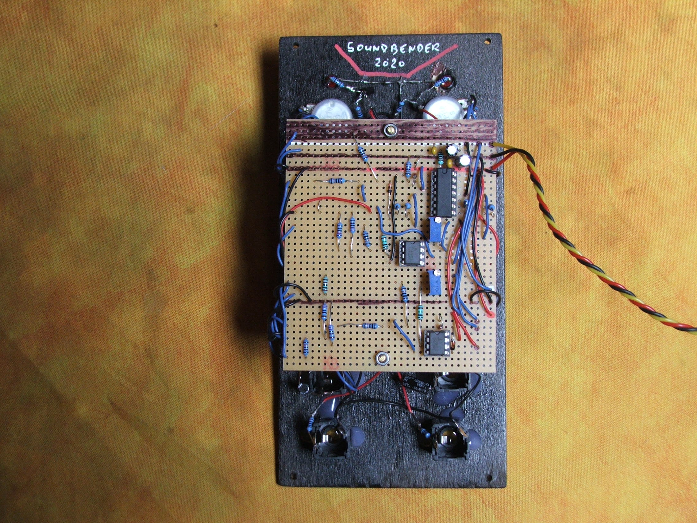

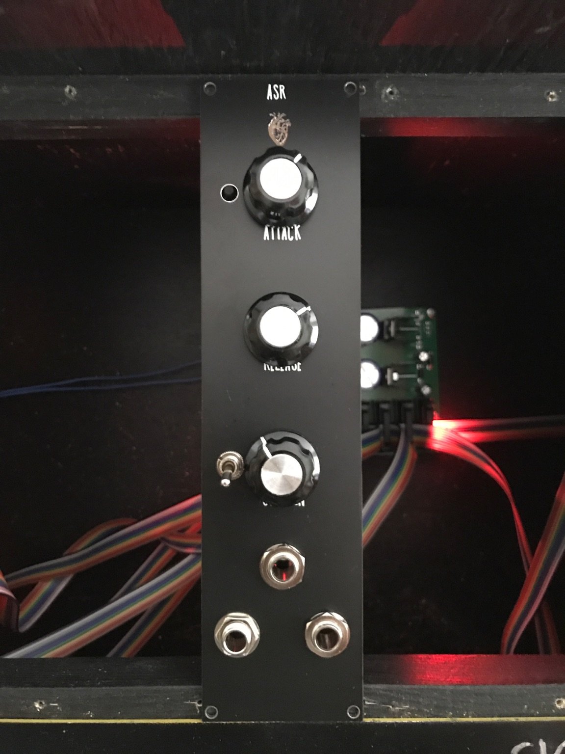

I finished my new envgen (based on Kassutronics again)! It has only Attack, Release and Sustain. Decay is set via the Release as well (they are always the same).
I botched the labels, they are way to close to the potentiometers and then vanish behind the knobs -.-
I put almost everything on the “inside”, so the components are between the main pcb and the panel, which protects them a bit more and looks a bit cleaner. I bought the wrong capacitor though, which is for 100V and hence so big, I could only fit it on the back
I put the LEDs behind the panel this time and made it transparent in this spot. I like the effect quite a lot, but you can not really see that there are two, one for the gate/trigger itself and one for the resulting envelope signal. Maybe I will change the color of one of the leds.
For the next version I want to add an inverted output in order to use it for a sidechain. And I need to see, if the design with the combined decay, sustain is right for me.
Lookin nice man, the heart is badass! I got your filter loaded up to go on my next order
that heart is freaking awesome lol

Should this be the Speak And SpeLfo

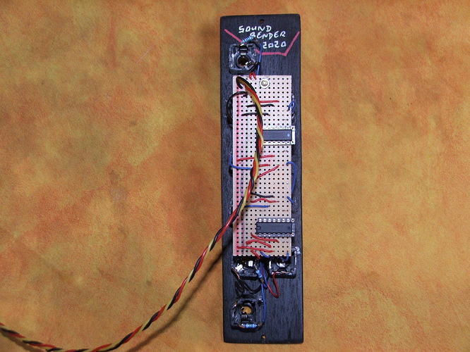

a Buffered Multiple with 2 positions (2 x 1 input with 3 out or 1 x 1 input with 6 out)
a little patch with it

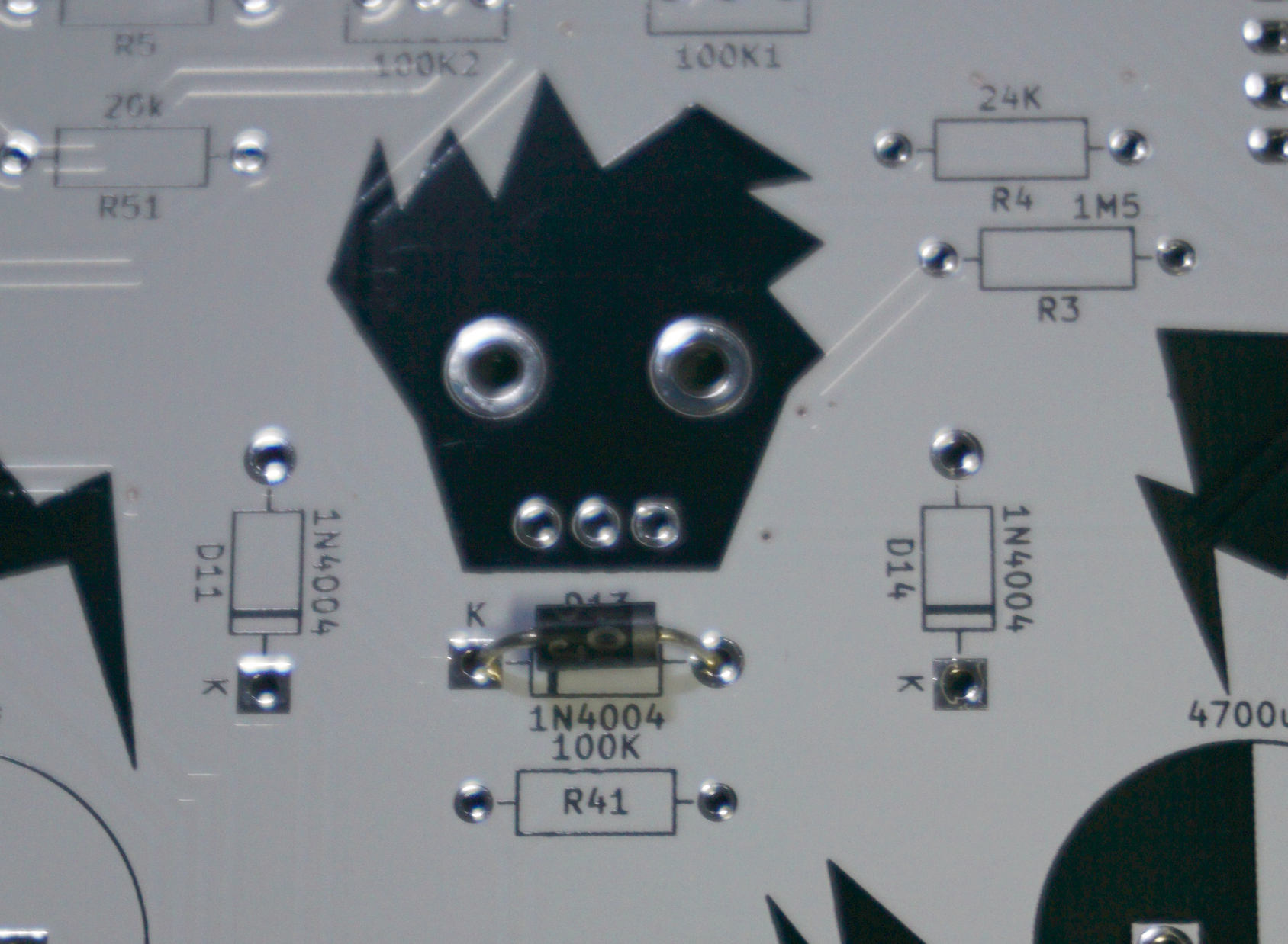

…aaaaand WE’RE OFF!
I figure if I just solder one component a day for the next year and a half, I’ll cut down on the likelihood of fatigue-related errors and GODDAMIT I PUT THAT IN BACKWARDS…
Fine, mr. diode, be polar…
There. All fixed. What component should I do tomorrow…?
Oof the first component too!
At least you noticed!
Dont be like me and get the chips the wrong way round. Somehow i put them on the wrong side on my adsr at first.

What is the module sitting on the table that has the red buttons on it? (far right of this image)
@binarymob - do you have a link for the sine shaper mod you found for the 3340?
That’s a Bastl Synapsis connected to my SoftPop. It’s effectively a way to add buttons to the tiny patches there in grid format. I was thinking it might be fun to make a similar panel in Kosmo format. Perhaps with switches as well.
