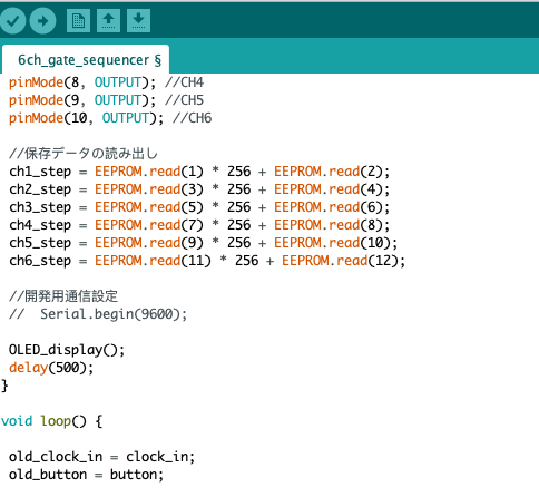

Wow, thanks Clarionut to look into yhis further. Glad that i’m not the only, and absolutely the only one having this. As soon as i get home, im gonna check this. I’ll let you know👍
Just added the code and build in the module. It works but lets see for how long.
I did notice the small delay for the oled startup and when I press reset, it takes a bit longer to refresh
so this means that I’ve placed the code in the right spot.
I keep y’all informed on how it goes from here but I have good hopes so. Thanks a lot for this tip.
If it keeps working I will let @HAGIWO know so he or she (I don’t know :slight_smile: ) can adapt the original code.
That’s the wrong way round. The delay(500) should be before the OLED_display() statement to give the display time to initialise itself before the Arduino communicates with it.
If this is the issue, it’s not related to how long the module has been running, it’s just related to timing on startup. So you should be able to test it quickly by powering it off and on again a few times.
Agreed, its the wrong way around
Hi,
I just changed to code as you advised. Delay comes BEFORE the oled_display statement (sorry I didn’t read well)
when powering up my rack, I now see some gibberish (a few milliseconds) and then the normal gate sequencer layout as usual.
I assume that the gibberish is the delay that is doing its part.
so lets play with it and see if this solves the issue.
The gibberish is just that the command to initialize the display has not been executed yet, so whatever is in the framebuffer of the display is usually shown on the screen until that command is issued, so the delay allows you to see what you couldn’t before by giving you a 500mS window before it clears.
If anything, seeing this initialization is pretty encouraging.

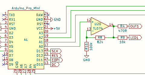

Only thing i did different was using opamps for each Nano output with diodes. Because then my drum modules responding. In Hagiwo’s version, he uses clamping diodes and a 470R resistor.
Can you confirm that the diode and opamps are ok? Or is it possible that they do something when switching on? The diode should block reverse current back to the Nano’s output. Right?
It’s fine to buffer the outputs from the Arduino with an op-amp, I don’t like the diode and resistor that Hagiwo uses either. You shouldn’t need a diode if you use an op-amp, just a non-inverting buffer configuration with appropriate gain for the trigger level you want to achieve. I used this circuit in my version of the Euclidean Rhythms module:
and similarly for the other three outputs.
