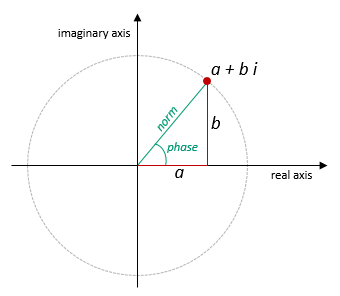

This really made me think of this “cool trick” (I like math, ok?): when you compute the FFT of two images, you can swap the magnitude and the phase of these two, and have two new images that share each other features. For example, lets take two “random” image on the internet:
Now, if we swap the mag/phase couple or the real/imag parts, we get:

Once again the real/imag mix doesn’t really add something… (but it reminded me of Homestuck somehow) drums_orchestra_phase_mag.wav sound nice!
And just FYI, this is what I have in mind when I’m talking about complex numbers:
