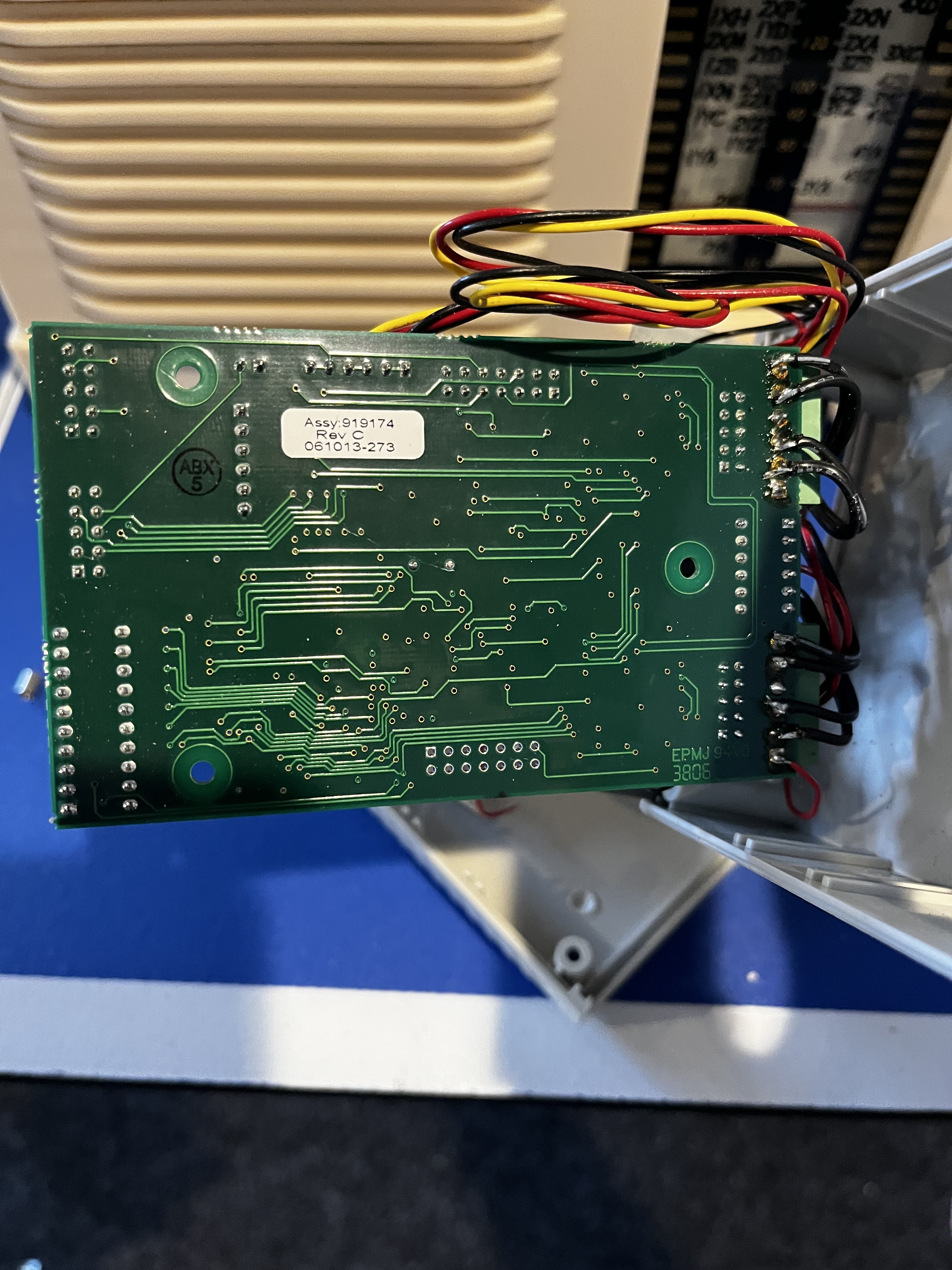

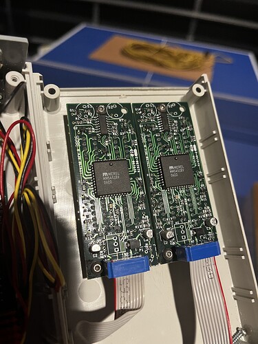

Picked these up today for $1 for the lot.
Apparently they were made and used by a broadcast engineer as test tools. So far two of the 3 LCD displays are working and pretty sure the third is too, just need to connect a 12v supply, but I have none with the correct barrel plug.
One will be mates with a raspberry pi zero in the near future. Tracker or orca running retro style ![]()
The surprise is the two audio level meters, they have some very nice but dated DSP cards with dual two channel codecs w/ 24-bit DACs. The are adsp-2184 microprocessors with references to windows 3.1 in the datasheet. Struggling to find any information on these board and there is no hint what power supply they might want or what the dip switches might do beyond âdisplay modeâ They are not the official ezkit dev boards. Any hints or ideas on where to look or ask appreciated.
