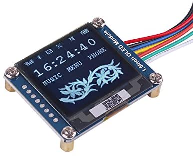

Here’s a display with 128x128 pixels, supports I2C. On the face of it this may be a good candidate for a larger display on the module. You still may have to adapt the code though.
Good info, I’ll check if there are other screens which are I2C compatible.

I’ve done a bit of searching but haven’t found any i2c displays with a resolution higher than 128 x 128. I wonder whether there is a technical reason for that. Any ideas?
At some point you reach the maximum practical refresh rate. The tighter the bottleneck the sooner that will be.
Here’s a link to a somewhat larger and higher resolution display I bought recently. It uses an 8 bit parallel interface with several control lines. You might get away with running that screen from an Arduino Uno or Nano, but to get the best out of it you need an Arduino Mega which has lots of data pins to spare.
