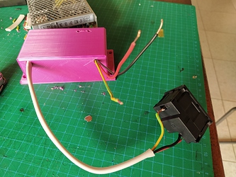

Hooked up my rt65b with a fused switch with kettle cable plug and 3d printed a neat little cover which will protect the cables. I’ll hook up a usb hub to the 5v rail to power some ancillary stuff next
