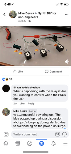

I wonder if something like this could work, though I don’t fully understand it:
