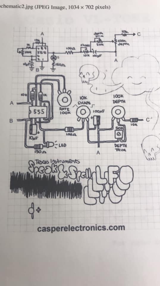

So my brother just gave me a speak and spell and he’s got one so now the challenge is on to mod it and see who makes the best mods.
dig deep into the way back machine on google and find Casper Electronics (BASTL Instruments) old website and dig around in the circuit bent speak and spell sections. you will find troves of modifications.
Also check out Rheed Ghazahla’s S&S Incantor bends.
unless you are from another country, mine (French Dictée Magique) had different bending points, but by searching we always find, and compare with others like you said Casper E or Reed G and test
in Circuit Bending is realy the stuff to have
Yeah this is all on one board no rom/ram chips it’s all on two IC’s I’ll probably be doing more adding effects to it and hold switches , will be adding a lithium pack for running an led screen and edge lights. Probably gonna add a torch lighter into it so there’s some fire as well. It’s really empty so there’s a lot of potential. I think our only rule will be no arduino. Only timers and op amps and the like.
oh… is this a black blob version?
Yeah it’s the new one , absolutely no Texas Instruments parts.
