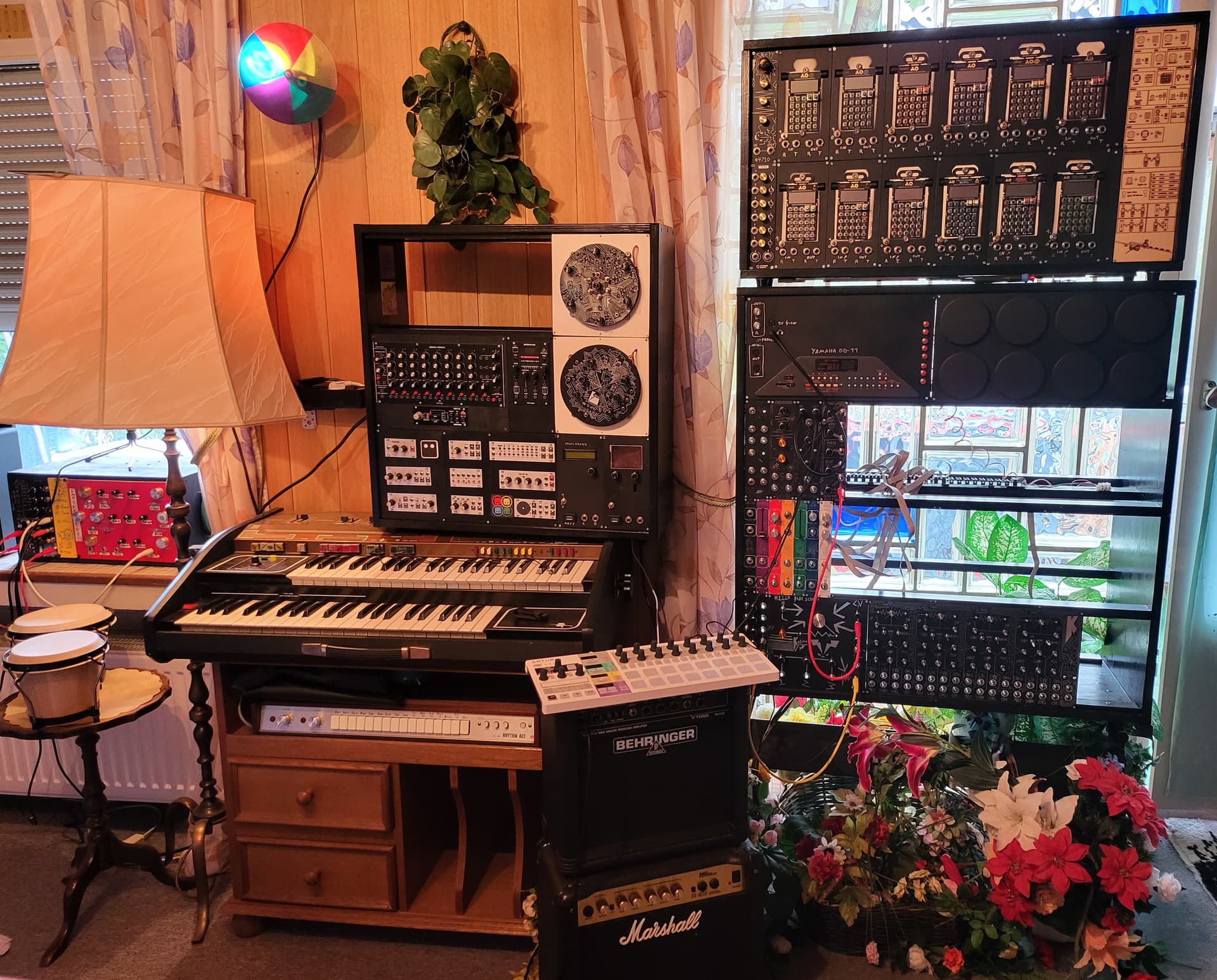

Only six months later and I had to build another case. My 4th, 60cm x 60cm x20cm.
Someone said this is addictive⊠naaaa I donât think so
the new one
the whole âperformance orientedâ ensemble for the entire family
the original in my space
I love the Teenage Engineering and 1u Intellijel tiles just screwed to sheets of plywood. Super practical!
I met Kosmo before Eurorack. That is why i kept some spacing.
I like the pro-modules for their
shinynes and I had mor GAS than time to solder ![]()
I like the wood work, painting and (sometimes) palning tooâŠ
so much
love, so little time and spaceâŠ

It looks great !!! ![]()
Have you ever daisy chained all of the pocket operators ?
@mightywombat : the Eurorack modules are just screwed in. for the POs there is a little bit more behind the faceplate. they run on synth power, the units with âPâ have a power converter and supply the others with energy which are daisy chained (1:3 ratio). every unit is separatly switchable. the small stereo jacks of the POs are split and extendet into two big mono jacks. the PO itself is unharmed, everything happenes around him
@Bpbby : i never chained all my POs to one large chain. I separated the channels so I can run them in paralell on one multiplied clock pulse and stitch them together later down the pipeline
