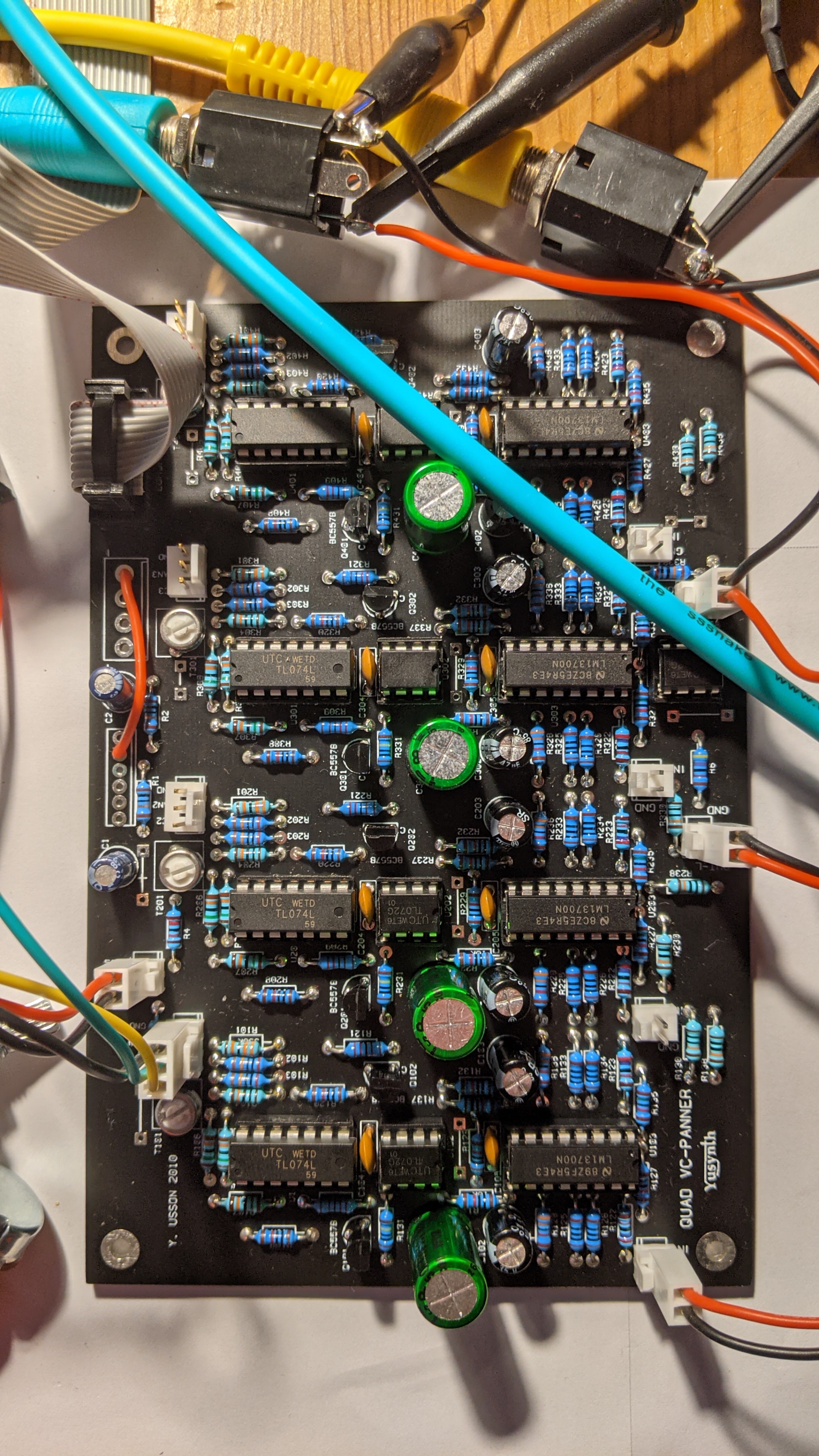

Today I finished the Yusynth VC panner. I wanted this for a long time and it’s awesome! Panel is still missing though. I hardly highly recommend building one.

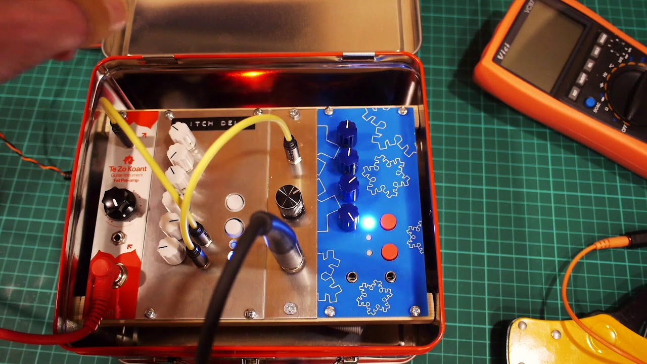

DIY glitch delay?:

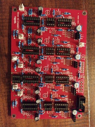

Waiting on parts for my yusynth vc panner. I do however have a nice pair of vu meters aside for it.
@Vumnoo & @jkb : it’s the YU VC Panner day :smile:
it’s seems to be a good module !

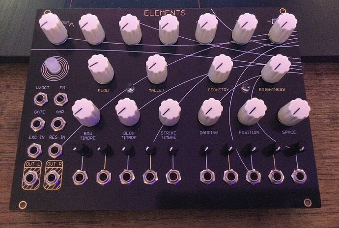

NOW the Elements that @popflier built and programmed for me is finished :slight_smile:

Woah, what is this? Perc machine? Karplus-Strong box?
Lust!

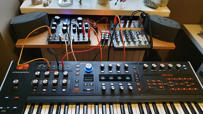

Today I finished building the Funky Filter :smiley: , but when setting things up, I accidentally hooked up the power cable to the link connector of the VCO :open_mouth:. I was afraid I totally fried the VCO, but after switching the ICs (TL074, TL072 and AS3340) with spare parts, it worked again :upside_down_face:. After a while I switch back the original AS3340 IC and I was glad it was still working :-), So I guess only the TL074 and TL072 were damaged.

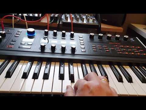

To be able to hear how it sounds, I connected the VCO and Filter to my Hydrasynth, which has the capability to send out Control Voltages.
I connected “Pitch Out” of the Hydrasynth to the 1V/Oct input of the VCO, the “Mod1” output sends the Envelop1 CV to the Filter Cutoff and the “Mod2” output sends the Envelop2 CV to the VCA0CV.
These are my first steps into modular synths, but I really like it. Next I will build the ADSR module and then it’s time to order some more from Sam’s store :wink:
I uploaded a small video to Youtube (which shows my limited keyboard playing capabilities). The Hydrasynth is only sending CV, so all you hear is the VCO and the filter.
? = Elements? Kinda.
Its by Mutable Instruments
Its a Modal Synthesizer.
