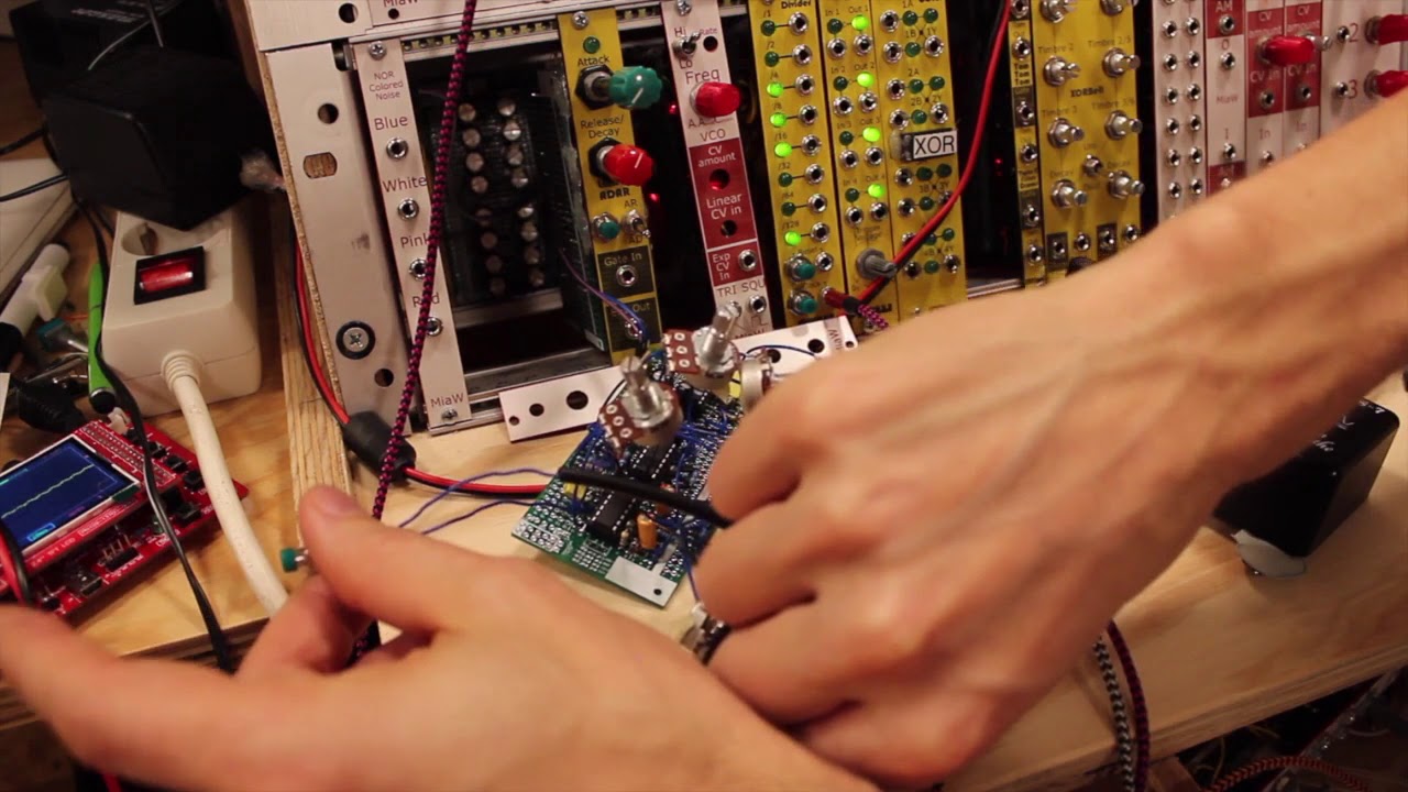

Building it as we speak. Need to order a few components, but I will let ya’ll know how it went.
Just finished it :sweat_smile:
Front:
Back:
And it sounds awesome!!

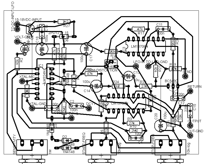

Does anyone have a good pc-2 or space drum clone on stripboard? My pockets shrivel at the prices of original kit. Come the revolution the use of the word ‘retro’ will be restricted (you’ve been warned world)
Is this what your looking for?
Yup. I remember Sam doing this video but like Sam, I’ve yet to find a schematic or verified stripboard that comes close to the simplicity of that space drum layout or it’s newer version. I made a note at the time that this might be a good project for easyeda.
I built one of the Rakit Drum Synth kits. It’s good but everything is so crammed and the noise is hard to filter out.
Found this on diystompboxes.com
Space Drum circuit
Thanks Marty. This looks much clearer than the one I found. Have you built this at all?
I can’t seem to find a BOM or other details for this on diystompboxes. Have you a link to the source for the diagram.
Sorry to pester you but if I don’t follow up soon my brain will file all of this info under forgotten.
Hi, no I didn’t build it but looks promising. I always read from schematic instead. not great at reading stripboard layout :slight_smile: I hope you will build it and let me know the results. I’m sure I have seen a regular schematic somewhere on the www too.
Maybe this could be working too..
https://www.diystompboxes.com/smfforum/index.php?topic=88200.20
Here is the link, scroll down a bit and you see the schematic and other info
Fabulous! Thank you Marty. Currently building another rubber midi drum mat for a studio in fife and I’ve decided to add a couple of triggers for a space drum. I’ll keep you posted. Cheer
