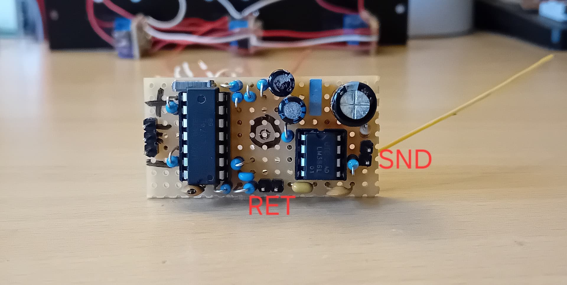

Hello Guys, I’ve built a Spring Reverb Module for Eurorack. I followed some schematics I found online, mostly for the driver of the coil, but also added Low and High pass filter (simple RC buffered filters), feedback and distortion. I really liked how the distortion worked, as it is a soft clipping type, and it acts a bit like compressor, it icreases the loudness. Then I found that there is kind of a bad flaw, that I am not buffering the input, which creates an unwanted second feedback path. So I created a version without this distortion. Here is a vide:

I was wondering if the spring has to be a special one (especially for music and sound I mean) or if any spring would work ? I am thinking that the sound quality would maybe not be as good but i cant see why it wouldn’t work ![]()
Well the reverb tank is a unit that comes with springs, I haven’t mounted them myself. But I’ve seen a video by one guy who build a spring reverb from scrap parts. I don’t think there’s something very special about the spring. The greater trouble are the pickups, they are like guitar pickups but bigger, I don’t know exactly how they function. But prebuild reverbtanks are commmon, you can find one on ebay for 10-20 dollars second hand. Now you have to adjust the resistor values for the driver for the different coils you use though
