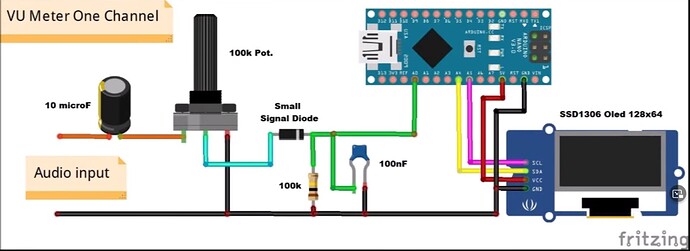

Found this and thought I’d share it:
There is more here:
I would at least add some protection to this circuit to avoid frying the pins of the Arduino, in case one forgets to turn down the pot :slight_smile: It might even be better to design this with a fixed potential divider. Like that, the meter is kind of calibrated.
