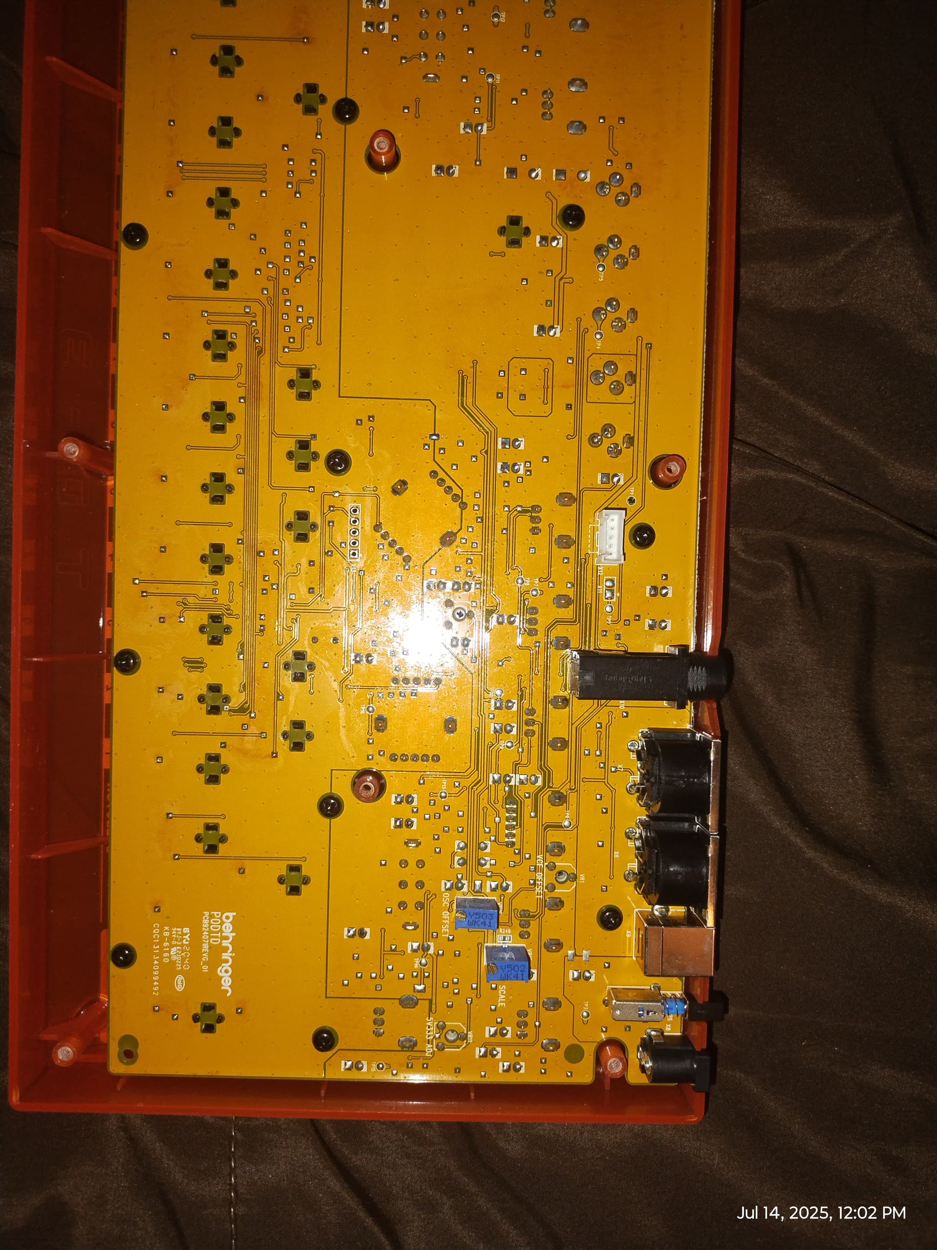

I broke what i assume to be a rubber gromet inside the osc offset inside trying to tune the sob, what is the name of the part of that and if what would be a good replacement? please and thank you and if i need to take photos i can here in a few of the insides
certainly going to need photos
So here’s some photos
It’s the osc offset I broke :frowning: there was prolly a rubber like a o ring inside the screw my dumbass just needed to calibrate it thru the synthtribe app
the blue thing? That’s a 50k trim potentiometer. Out of curiosity, why do you think it’s broken?
Can’t screw it in to adjust that’s what I’m saying likethe lil screw after I tried to tune the osc offset which I didn’t need it to do, it’s like stuck once you try to screw the osc offset
I got the scale tuning good I’m jamming on it rn like it sounds good with other synths going off like it ain’t to jarring like it was before so maybe I fixed and now the offset for the tuning knob is now like off center to get c3 or whatever I’m suppose to be looking for
Nah the machine pretty sharp lmao im dumb
I have no idea what is going on
The tuning is off after adjusting the osc offset dawg, Ive said it before. That trim pot won’t adjust . Do need me to type this a third or forth time?
I striped the 50k tim pot basically thanks . I figured it out
