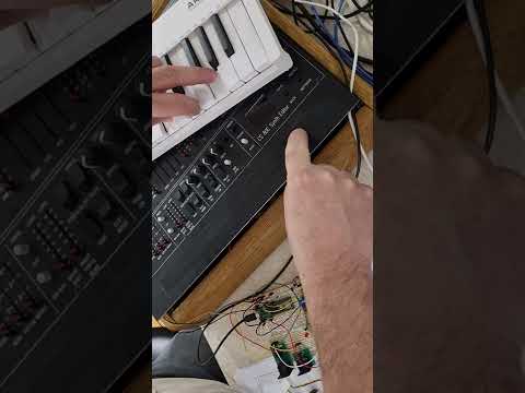

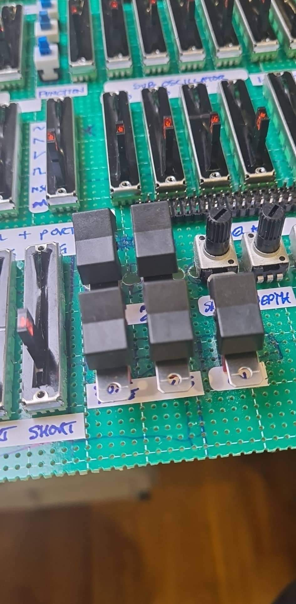

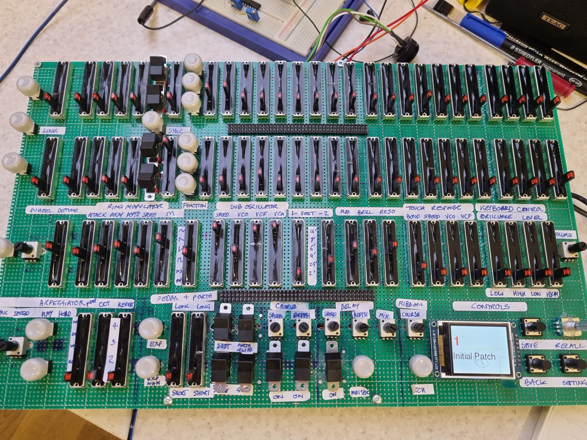

I had built a 64 channel mux/demux for a previous project but I wasn’t happy with it so it was put to one side. So I decided that I could reconfigure the demux into part of the mux for 128 inputs.

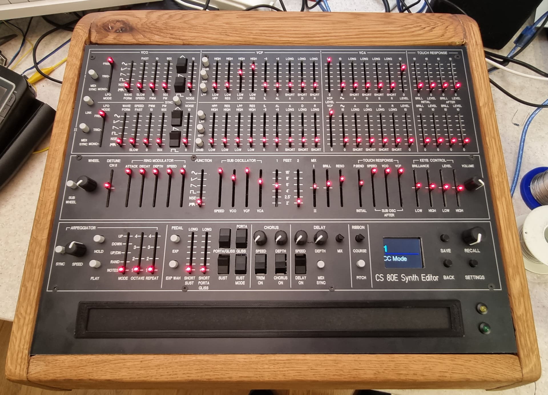

Having done this and picked up about 120 cheap red led sliders it was time to make an editor for the Arturia software. Finding the right rockers and push buttons was tricky but I’m happy with the results.
LEDs are dimmable and you could recall 999 settings for the CS80v and send them over midi as CC messages. Or just edit what’s on the computer screen.
I also added a ribbon controller which seems to work ok but might need a little refinement over time. Maybe when Putin stops shelling our country.
