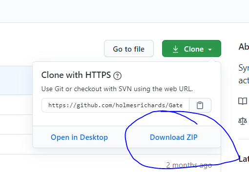

github confuses me but I found the BOM, not sure I understand R15, R16 resistor is “RL”
Explanatory comment added to BOM
The simple way to dl stuff from github is clicking the clone button and clicking the download .zip file.
