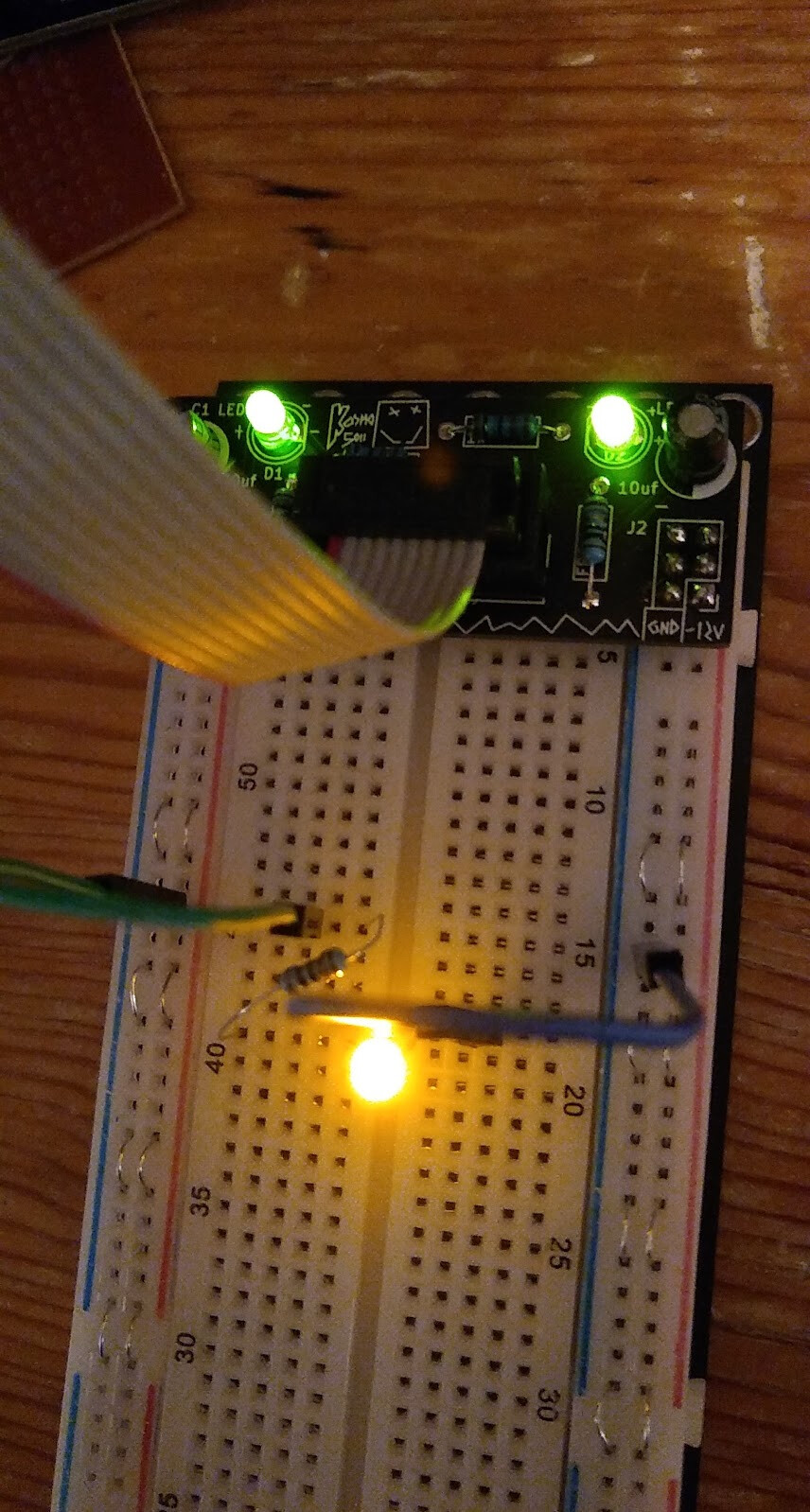

This has also been released the Lego To Breadboard adapter.

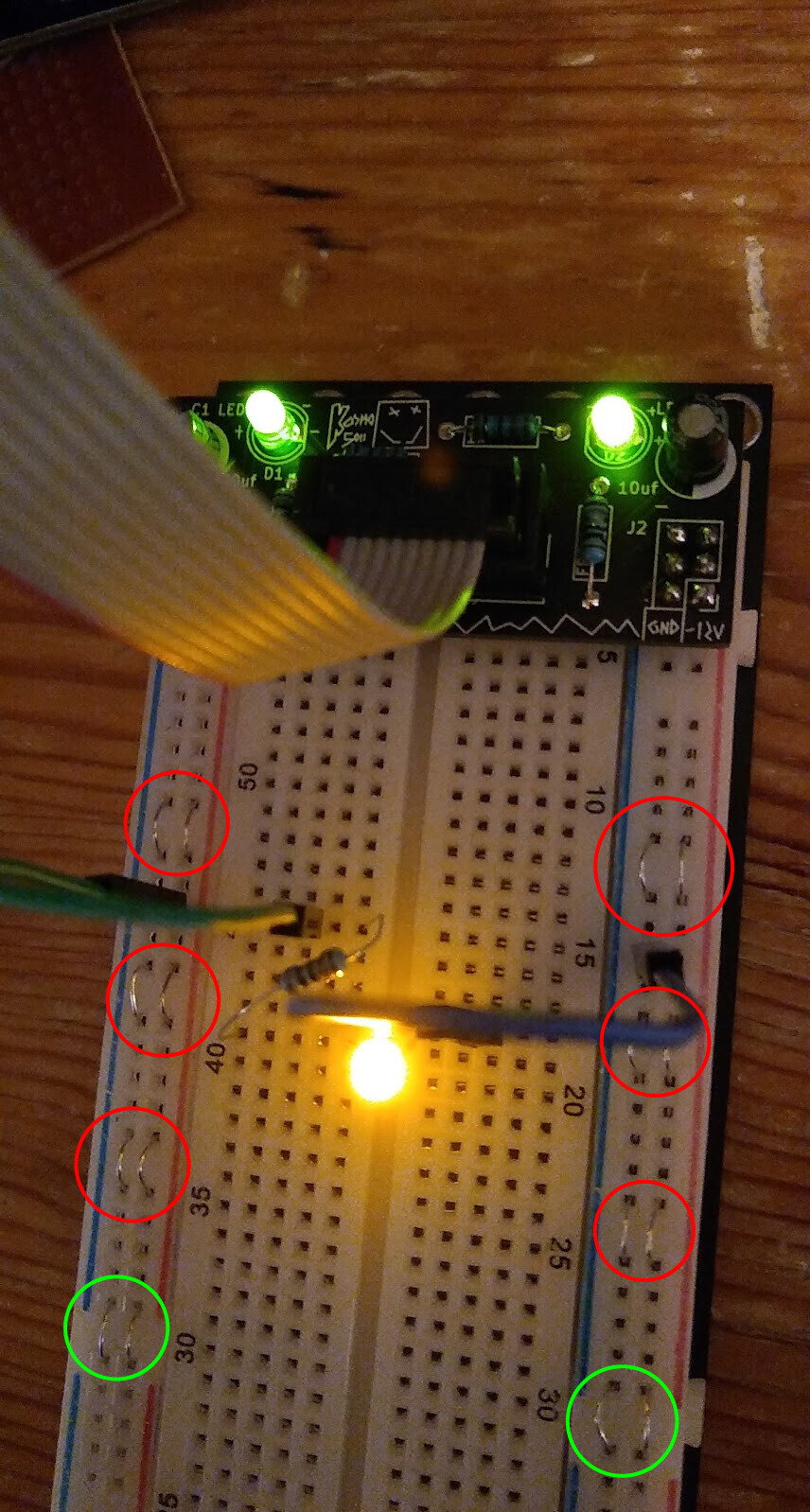

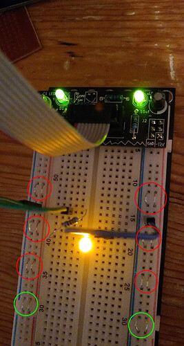

The jumpers circled in red are useless…
The ones in green are necessary on some breadboards (including yours, the red and blue lines are interrupted)
