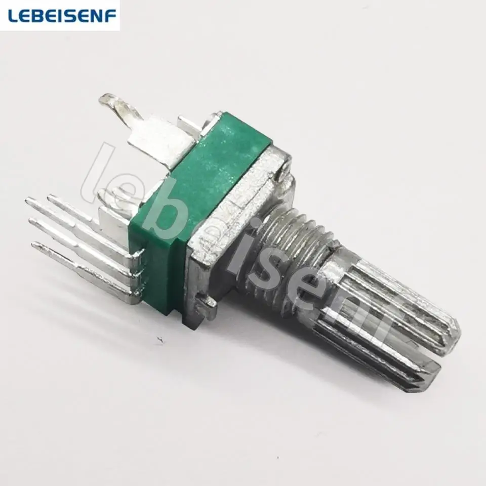

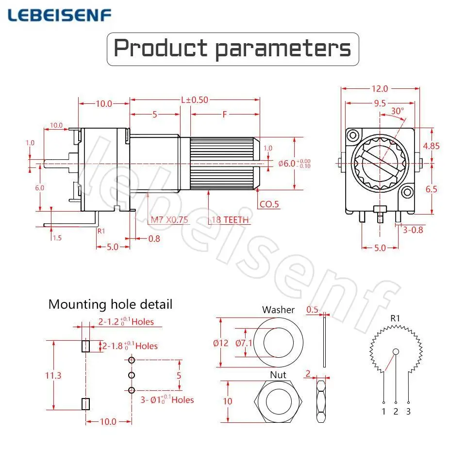

Do you think these potentiometers (datasheet) and these jacks (datasheet) will fit the PCB and leave the right space for the panel on front?

Yes and yes.
In fact the BOM says for the jack Tayda A-1121, which is this, which is PJ-629HAN, which is what your datasheet shows.
That’s great, many thanks!
