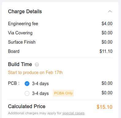

Has anyone tried to order anything from JLCPCB in the last week? The order I placed on 1/25 was able to generate black PCBs for faceplates for the expected $4 engineering fee and $3.80 board costs, but when I go to place this morning white and black PCBs have a $15 color upcharge, and purple/red/yellow/blue have a $30 pcb upcharge. This doesn’t look to be related to the new year, as they are flagged as not being eligible for production until after the 17th.
I did not notice any unreasonable spikes in pricing in my recent order. the board is almost identical. i probably got special pricing for small dimensions. in my case i pay more for shipping and taxes almost every time…

JLC prices for 5 boards under the minimum size changed all the time for me last year, from 3.5 euros to 6.5 euros shipped. I probably evens out more on large quantities. Even the “worst” price is really good so eh

Color upcharge sounds to me like some error in their software, or a misguided holiday period pricing change quickly rescinded.

Going to have to do more investigating on my end, as the audio mixer gerber (thanks Siri) I have uploaded still has a color fee toggle on when selecting black:
Have kiddo responsibilities until later this evening, will try to figure out what’s going on and report back.
in my experience when going lead-free, a lot of colors entail a surcharge almost every time, that they wouldn’t add if it was hasl with lead. only green and black seem always available, and blue and white also frequently available… the rest always ask you to pay more or swap to green. though on your order i don’t see a surcharge for surface finish so it might be due to quantity or something else

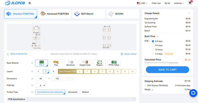

I checked another design, still no upcharge, here’s the complete order page so you can compare options:
With LeadFree HASL and white color:
Extra charges triggered by Green → White appear as Special Process Fee rather than Color.
