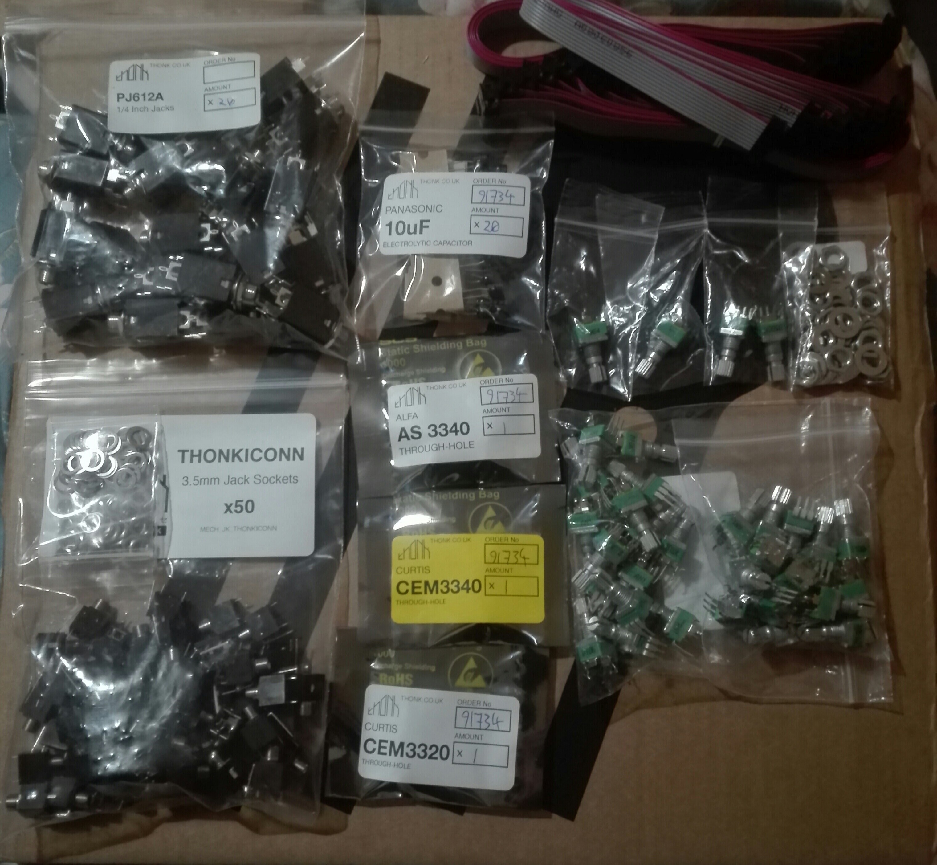

Got my thonk order in. Got to have a word with royal mail tho… my bin is not a safe space to leave my parcel XD
Well atleast I have my order and dont have to go queue up with non masked scrubs.
20 ¼jacks, 50 3.5mm jacks, Pots (1 5k, 15 10k, 1 25k, 15 100k, 2 500k) CEM 3340, AS 3340, CEM 3320, 20 10uf Ecap, 13 16-10pin power cables.
Would have thought id get a free sticker or something haha.

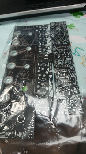

Also another package from @eric with the DAC ino PCB and panel for Quantizer module from @analogoutput .
Thanks a lot @eric !!!
When I saw the panel in +, I told myself that it was really very beautiful and really more beautiful than my painted wooden DIY panels, but my aesthetic side told me that I still did not want to see a different panel in the middle of the others in my case.
Actually i’m sorry but i wouldn’t use it, no matter how nice it is, so if someone is interested in a single Quantizer panel, let me know, I will send it. (i’m in france :slight_smile: )

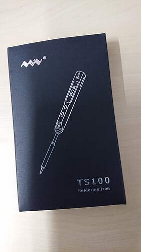

Thought I would treat myself, as in addition to the big soldering station at home I needed something half decent for the workshop I rent.
Looks nice!

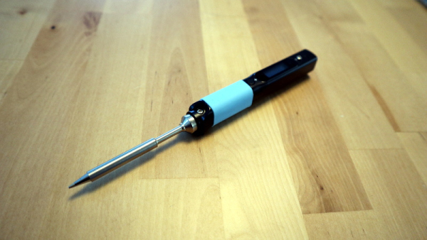

Interesting recent review of a new TS100 competitor

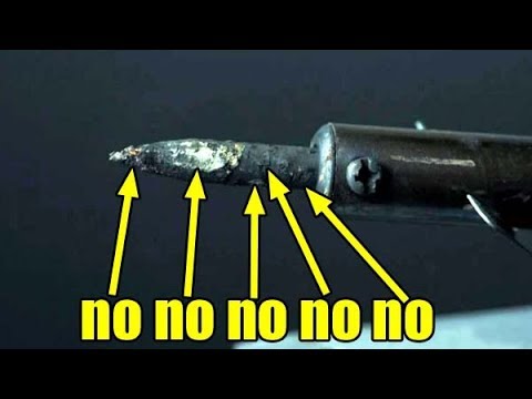

If it’s just got dirty then flux paste and solder will clean it. Just dip hot iron in flux, wipe, then add solder, wipe and repeat many times until clean.
This has been my method (despite the clickbait image), as well as trying to leave a blob of solder on the tip when I’m done.
@twinturbo, that is the same iron I use.
I found my TS100 to be more than just “half decent”. I bought it on a whim just to use as a field iron … but after testing it out found I liked it more than my Hakko clone station. Now the station gathers dust and the TS100 gets used on everything. It heats faster, can transfer heat quicker, and actually feels better in my hand (which really surprised me as just looking at it I thought the ergonomics would be terrible.)
My only complaint is that the cord on the power supply that came with mine is annoyingly stiff and short. But that’s easily solved with a different power supply.
Ok, a slightly better tip selection would be nice as well, I wish there was a smaller chisel tip available. Or at least a real chisel and not just a cut off cone. The only chisel they have is too chunky for me so I use the cut off cone.
The rod diameter is standard for that type of iron so you could have a go at the cheap generic tips available on aliexpress for the “phone repair” market.
The TS100 tips? They’re not just tips like a normal iron, they’re integrate cartridges with the heating element and temp sensor (one of the reasons why they work so well.) I’ve used generic tips on my hakko clone and actually found some that I like much better than legit hakko tips on there. But for the TS-100 I haven’t found many generic options and none with the shape/size chisel I like.
I have seen people use JBC cartridges on the TS100 but the ergonomics don’t work out very well.
And honestly the more time I spend with the cut off conical tip the more I get used to it, in some ways it’s more flexible than a chisel. But for some SMD touch up work I just find it too clunky compared to my old hakko chisel and the fine tipped conical I have (The TS-ILS) is too fiddly and fine. I liked the chisel for SMD work since I could turn it sideways and it was almost as thin as a conical…but had more mass so held more heat. The fine tip conical just doesn’t have enough mass in the tip and doesn’t transfer heat for me as well.
I guarantee there are TS100 tips out there. Cheap and generic. It is how this type of iron came to exist… an off shoot of the vape boom I think.
