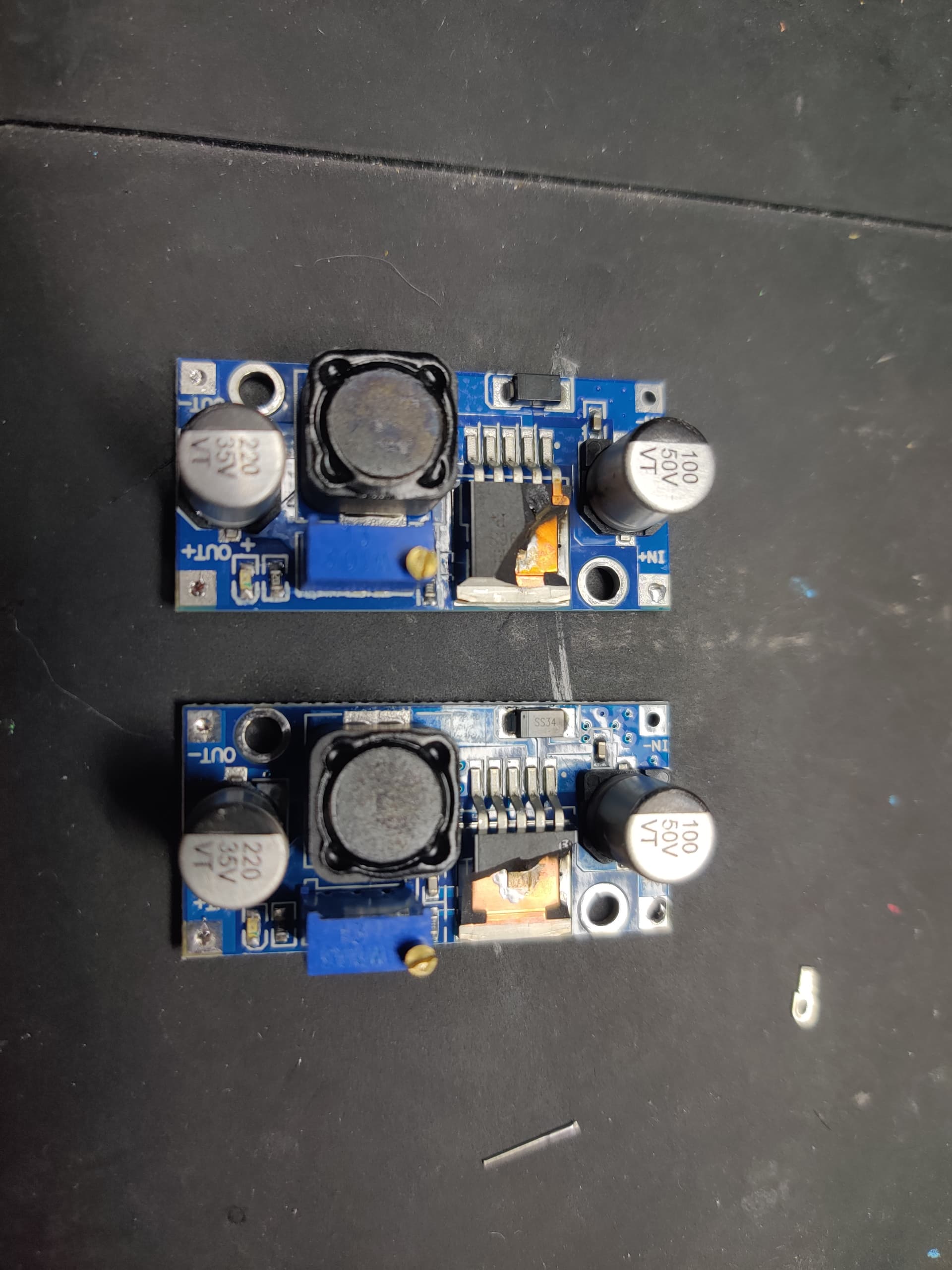

@ehisforadam did not have success with the nozoïd design.
I took a gamble on the Nozoïd design too, since those modules are super cheap.
An Aliexpress seller seemed to have one with all the proper characteristics, but it turns out they sent me a revised revision: JM21RP LM2596S, HW-411, despite advertising older specs.
Sadly, I’m not getting it to work. When wiring two supplies as indicated, my bench PSU goes into CC mode and drops the voltage, which seems to indicate it’s shorting.
I saw online a different way to wire them up to get negative voltage:
I have not tested it, but even if it worked, I would not trust the resulting contraption too much.
“Super cheap” is more a warning sign than a virtue especially when it comes to power supplies. Trying to cheap out on power is almost always a mistake.
@ehisforadam reported three Nozoïd supply modules blowing up before he gave up on them, link above and this:
Apparently no synth modules (or users) damaged in these disasters, fortunately, but I still would not let one of these things anywhere near my synth.

But yeah, I also tried another similar module I forgot I had, the correct board without the HW-411 REV, but a JM08RP LM2596S-ADJ. That one too doesn’t work, just draws as much current as it can. Those modules are definitely too much trouble even for a small test rig. You need the exact specific version from vendors who frequently switch components.
