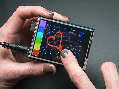

You know, I have one of these sitting up in the project closet from a quadrophonia experiment that kind of petered out:
I’m tempted to see if I can work out the code now.
