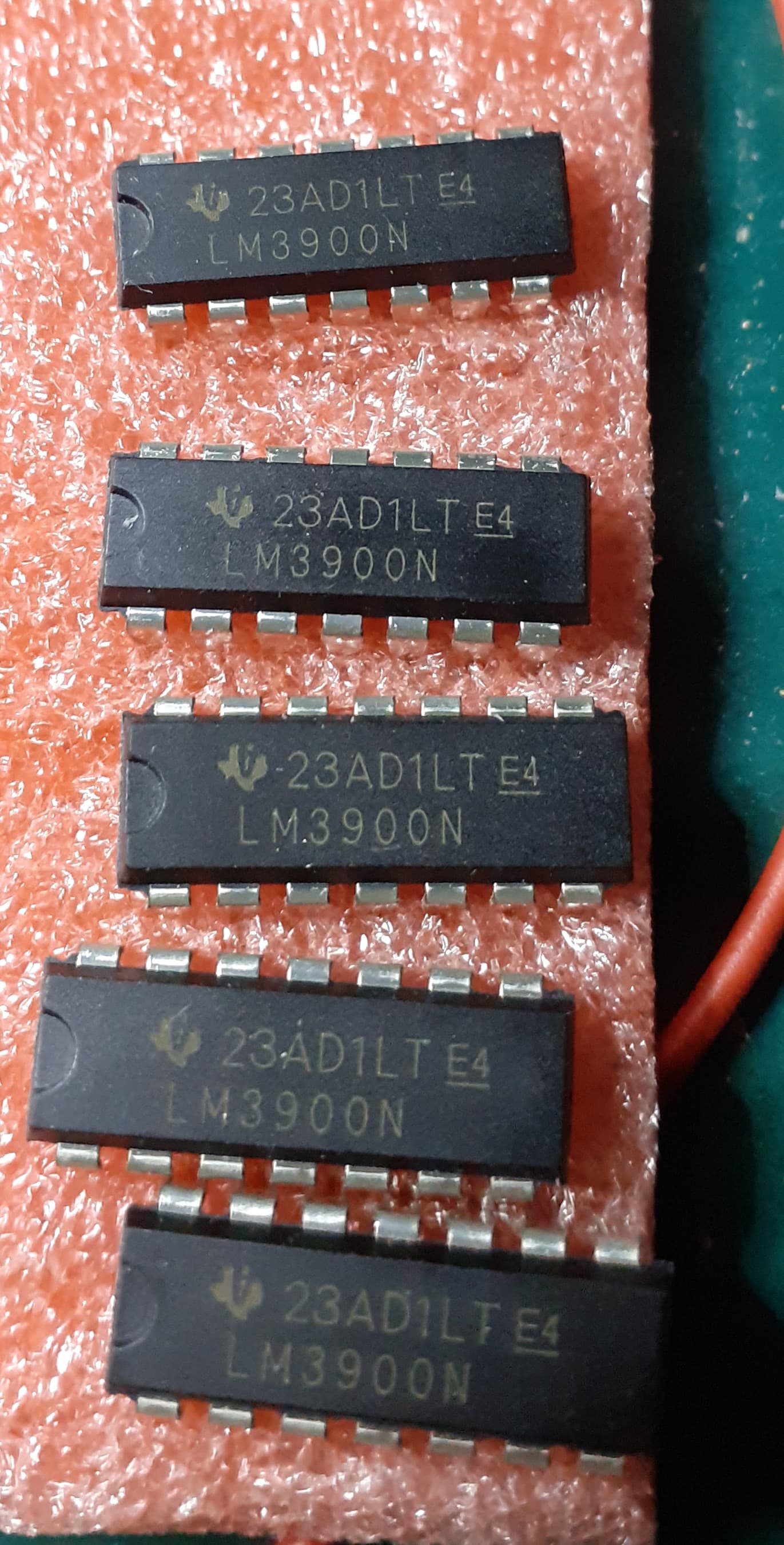

Not TL’s but still, none of them worked.
Luckily I had a positive so I could build a testcircuit which worked, but these turned out all to be negatives:
Familiar odd TI-branding …
Bought at aliexpress, I obviously disputed the delivery and …
the dispute was decided in my favour IMMEDIATELY (read: within a minute) after entering the dispute.
The question is, if not LM3900, what are they? ![]()

I suspect they are quad opamps of some sort, but I don’t know. I will try them in a quad opamp configuration and report back.
[Edit] As I suspected, all are (working) quad opamps.
