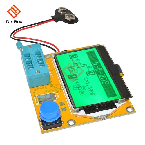

This should be right. @Forreal you should test with a multimeter just in case. If you dont have one, you should get one! They can be obtained for not much cash and you will absolutely need one for DIY electronics.
They struggle on real low cap values, but if you put two caps in and divide the result by two that works. My fluke does not do Capacitance but my £7 Cheap Vichy VC97 does and gets similar results to the LCR but can get lower.
