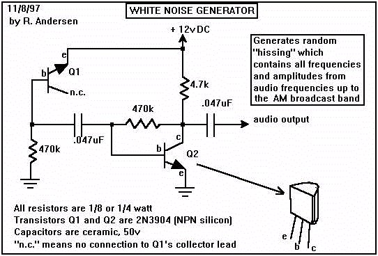

Another “white noise only” version (don’t recall the source, but it includes attribution.):
Snare_Noise
The more voltage you pump into it (up to about 18v I think) the better.
